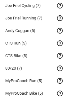

From the settings screen, when looking at the HR zone setup
  • click 'Heart Rate Training Zones :pencil:
  • click ‘Presets’
  • click on any of the :question: to get an explanation (or search the name in relation to HR zones)
