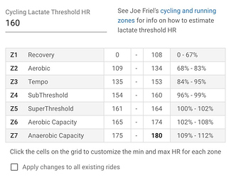

But I tend to think of my HR zones as %ages of my max HR, not my lactate threshold HR. I kind of get that you’re making the zones work around your LTHR, but this…
…just looks untidy and hard to process to me, to be going from 0-112%. 100 should be max!
I would much more think about Endurance as 60-75% of max, maybe, tempo as 75-83%, etc. And then the final zone (I prefer to think of it as the “Max Capacity” zone or the “Oh, F***” zone) is 95-100%.
It just feels like there should be a solution where LTHR is still a usable metric, but the % benchmark is your HRmax.
It’s not @david’s idea to make it work around LTHR, but Joe Friel’s (http://www.trainingbible.com/joesblog/2009/11/quick-guide-to-setting-zones.html).
In my case it’s 114% (152 - 174)…
Yes Cyclopaat is correct, I based this Joe Friel work. I agree that using % of max HR should probably be an option.
I think your LTHR is a very valuable metric and it’s not weird to center zones around that. Max HR is still 100%, just not of LTHR :sunglasses:
By comparison: on Strava, Z5 is max HR (100%) and up. Now, that’s weird…
The best reason for using LTHR rather than HRmax is that getting to HR max can be dangerous – especially for older folks.
my life is spent bouncing around lthr to get best from legs :laughing: very happy with Joe Friels 7 zones
