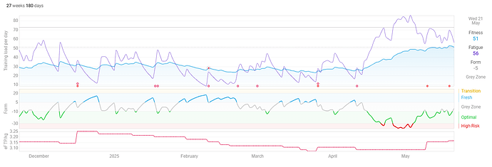

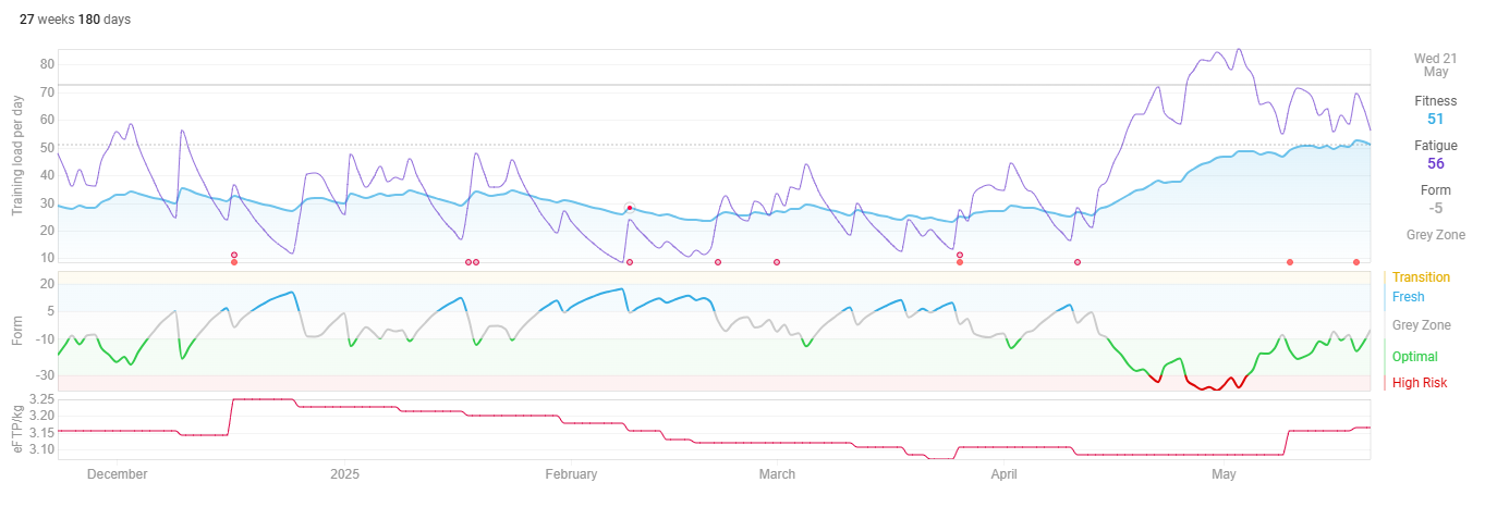

Last 6 months fitness chart is below. I use 6 months because I was seeing HRmax of 189 in January. I think the time high I’ve ever observed was 194 when I first tried a HRM running in 2007. I’m going back to my old pre- Garmin Connect data to see.

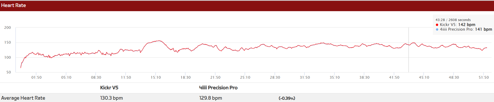

I agree - When I say consistent I just mean that I’ve been seeing similar numbers for similar rides when I switched between. The Garmin wrist HR I’ve found has always clipped the highest values, but tracked decently at lower values. I haven’t dual-recorded with them yet. Plan to record with two devices today, I got a new Garmin strap as I was suspicious of the old one. Yesterday was an early morning ride, today is evening.

I was just going to do a Zwift ride and record it with my Garmin as well to do the Dual Recording analysis on ZwiftPower.

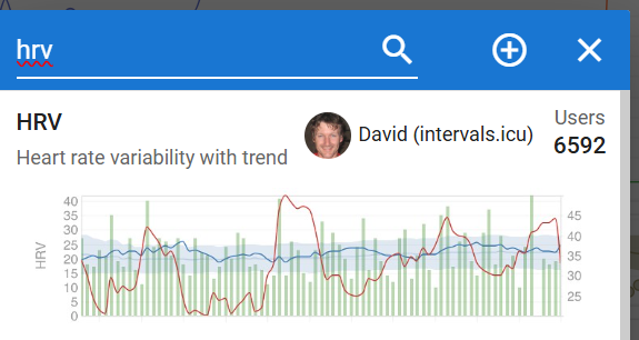

What might also be interesting is a long-term HRV and RHR trend graph — it’s available as a pre-made fitness graph directly from David:

It’s certainly possible. Sure looks like it isn’t equipment after my ride tonight. Old chest strap and new Garmin HRM-Pro tracked exactly.
There is a lot of activity in the winter that doesn’t get captured in my log (curling, snow clearing, etc.) so the bump this spring isn’t as big as it looks on the graph - but it’s definitely more cycling than I’ve been doing, and fewer days off.
Okay - tonight’s ride tracked almost perfectly with my old chest strap and my new.
Looks like it was likely real.

:bar_chart: What your chart says
  • Fatigue > Fitness for weeks = accumulating load
  • Form ofte in the High Risk zone in May
  • Resting HR drop + low HR during max efforts = suppressed cardiac response
  • Yet still hitting new power records → classic functional overreaching territory
