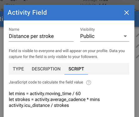

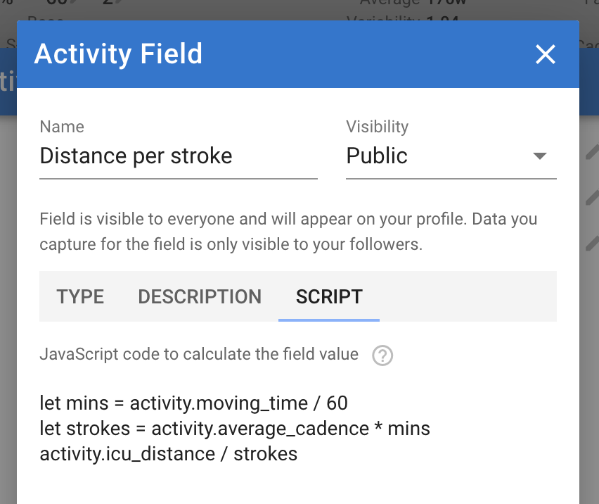

Thanks! I added a custom activity field to calculate distance per stroke:

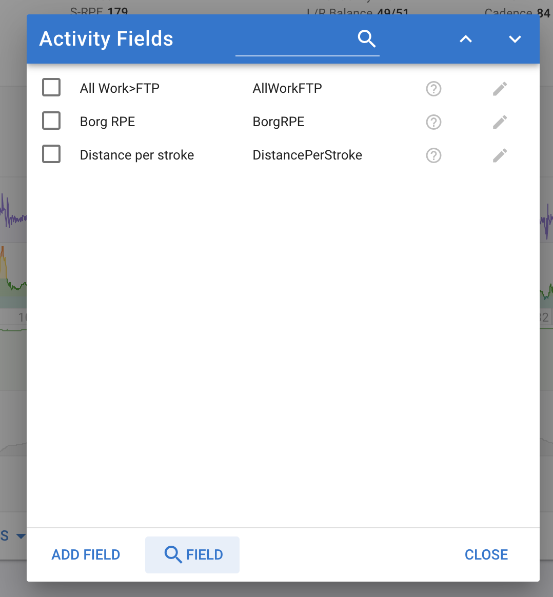

You can add that to your athletes. Select one of the athlete’e SUPs and click “Custom” under the activity timeline chart and then search for the field:
You will need to re-analyse existing activities to see the new field value.
Unfortunately you can’t see this for intervals yet, only the whole activity. I will be working on custom fields for intervals soon.
