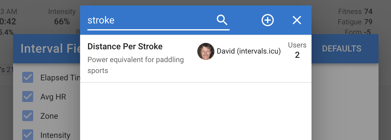

You can get distance per stroke for intervals. Click the search button:

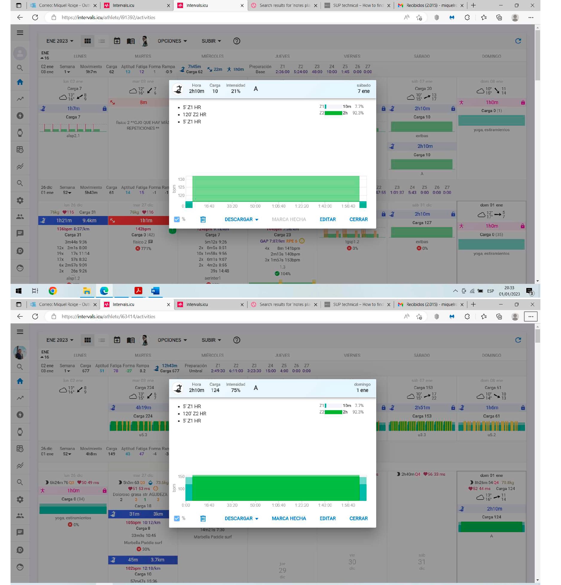

do you know why the same training looks so different in two different athletes? is that normal?
