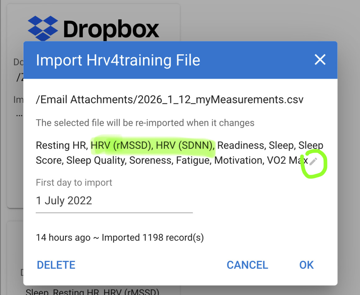

For iOS, both options to export, to Dropbox and via email (also to Dropbox) work from HRV4Training. Both values (SDNN and RMSSD) are pushed though.
On a separate note, SDNN should be used on long duration measurements (usually overnight) and not the short measurements like 1-5 minutes in the morning.
Exactly. So I want SDNN from AF Apple health and RMSD from hrv4training after minute breath on wake up. All in intervals.
For HRV4Training data coming into Intervals, in the Dropbox settings, you can exclude SDNN.
The value in the Dropbox file is the same as the value that goes to Health, which is from HRV4Training and not Apple.

I’m using it with android phone the same way as you are using. HRV4T export to email, save the file into Dropbox, and auto sync from there to Intervals.
So it is working for sure.
@ohmax if you need any help, let me know.
For me, the email2Dropbox option stopped working in early April. I’ve reverted to Export to Dropbox directly from HRV4Training and it’s working like it always has.
