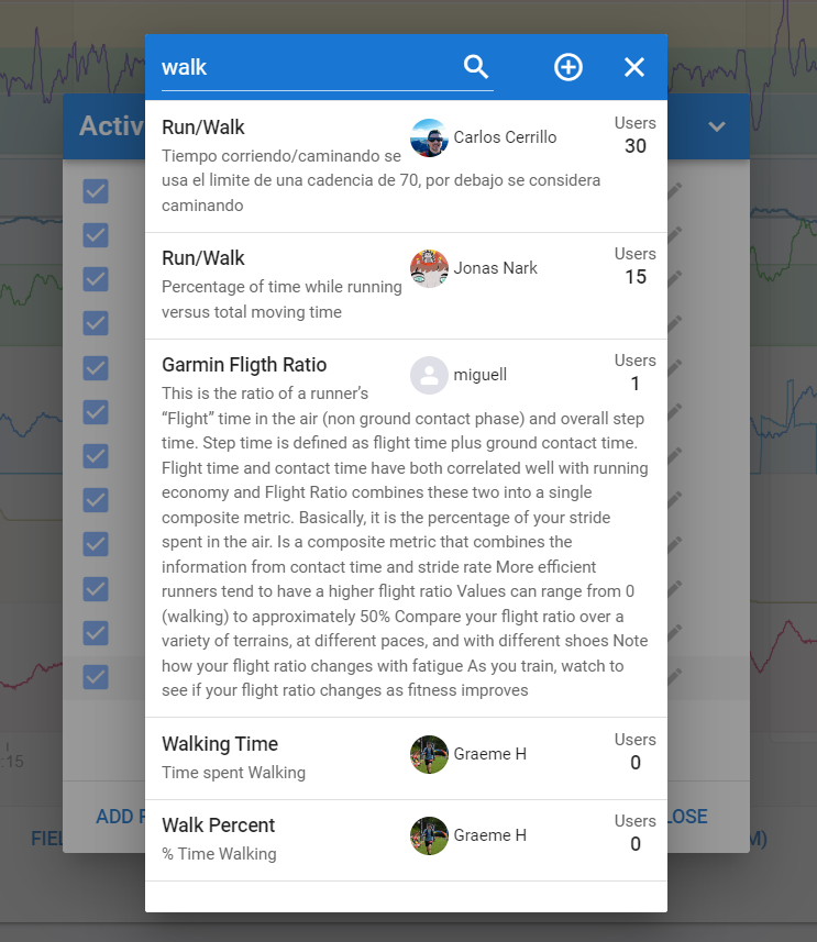

I could try cadence and see if it works. How do I get to that screen in your picture?
In the script you wiil see cadence threshold at 65. That´s how cadence is logged, a full L/R cycle iso 130 which is mainstream for walk/run.
You can play with it to find out which value gives best results for you.
