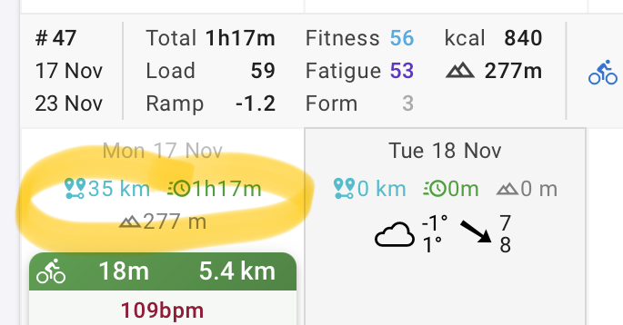

You can do that at least for the day. I use a fitness chart for that

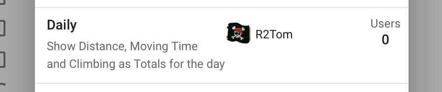

It shows the totals of the day on the calendar:
