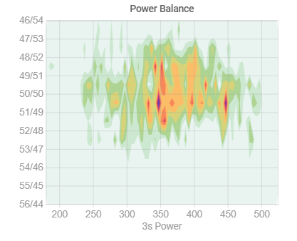

I use the built-ins of intervals, though I long ago stopped looking at smoothness.
This is my favourite chart to review (sample from shortish online TTT race):
LR balance is stripped out if your data in intervals is coming in via Strava.
Do a direct connection whenever possible
