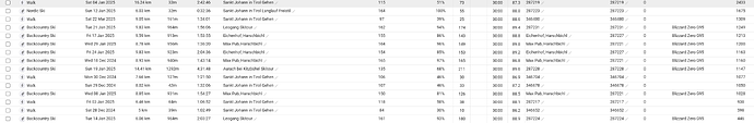

I just noticed that some of my activities have a completely wrong Threshold Pace setting (see screenshot). The odd part: I can’t seem to delete or unset the threshold value for those activities – it keeps reverting back to 30:00 no matter what I try. (–> Must be between 1s and 60m when trying to remove it from Activities Detail Page)
Any idea how to completely remove the threshold pace from these activities? Especially since these workouts don’t even have a threshold pace to begin with.

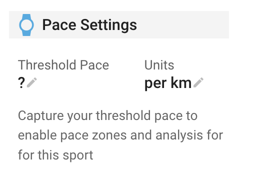

WHat you can try is
  1. delete the sport which has the pace alry set
  2. re-create the sport you deleted
  3. this will result in a pace which is EMPTY
Screenshot 2025-04-25 at 6.03.32 PM
I don’t know if it would work for you. and it’s a “nuclear” option.

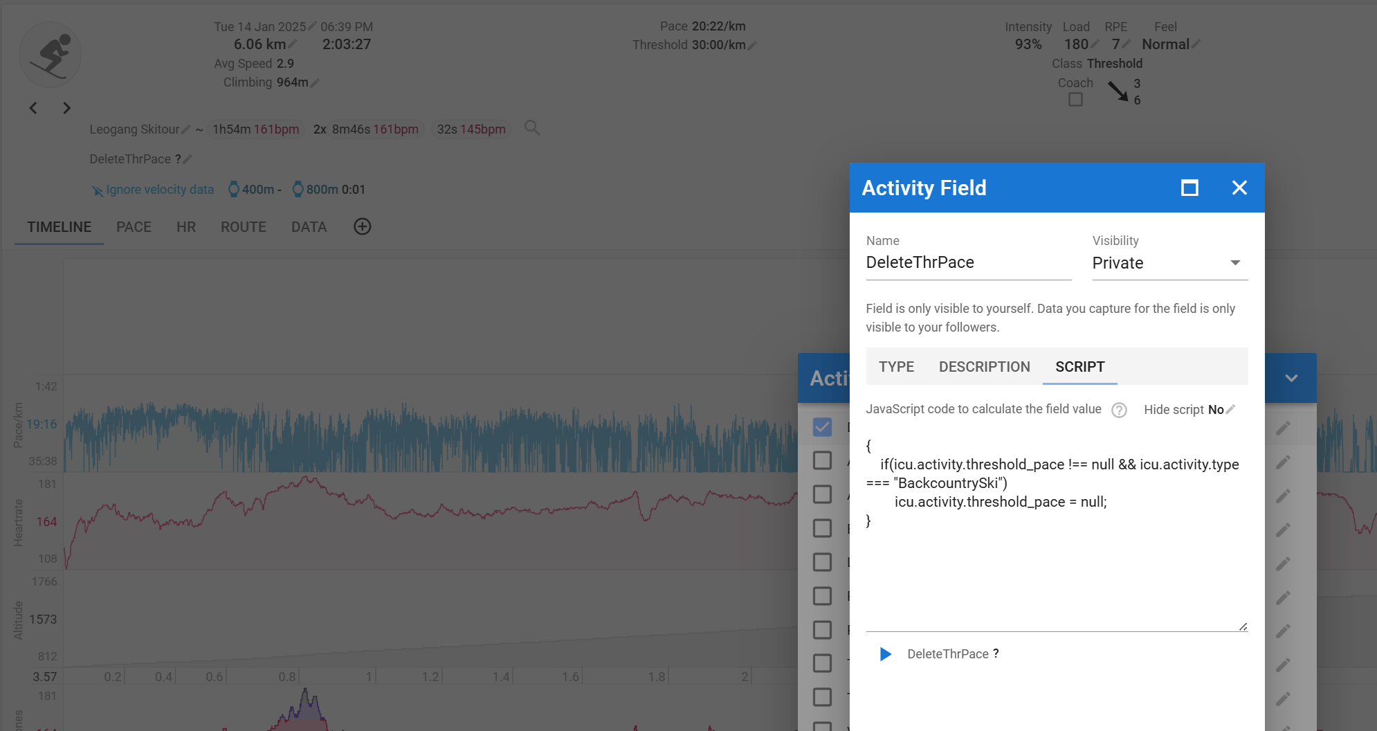

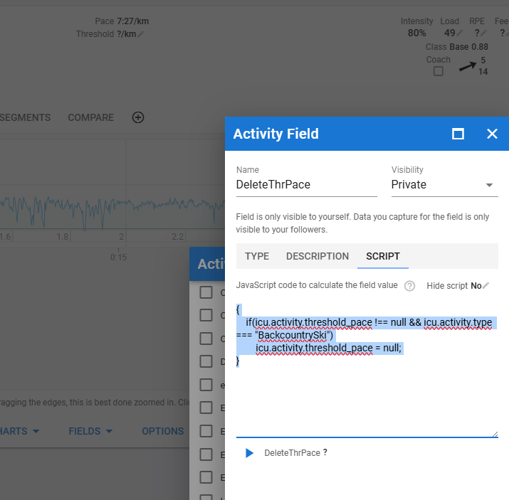

This is just a workaround, and you should probably delete this afterwards, but only option I see currently is to set it with a custom script or external API.
    if(icu.activity.threshold_pace !== null && icu.activity.type === "BackcountrySki")
        icu.activity.threshold_pace = null;
That seemed to work.
Hey that’s a nice approach! :+1:t2:
But unfortunately it’s not resetting the Th.Pace in my case? Anything I’m overlooking here? :thinking:

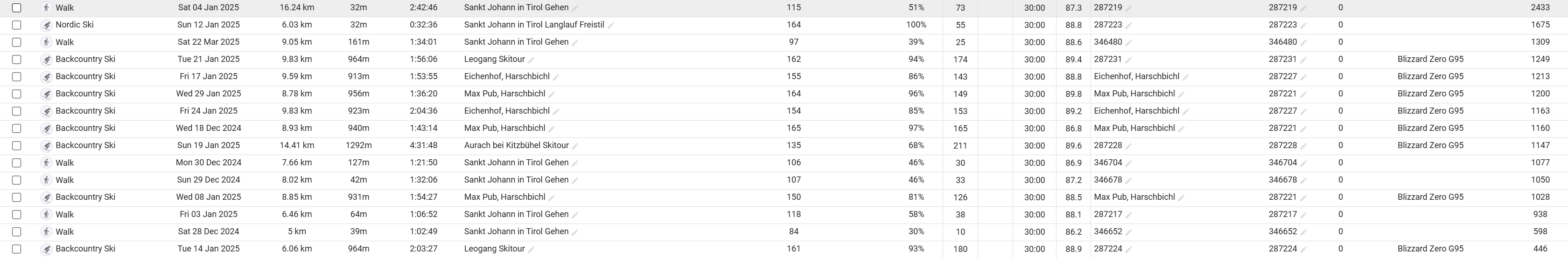

You have to reanalyze those activities. (Action → Analyze)
thx a lot - worked like a charm! :+1:t2::+1:t2:
Now “Totals” - “Pace Zones” isn’t totally broken anymore … ^^
