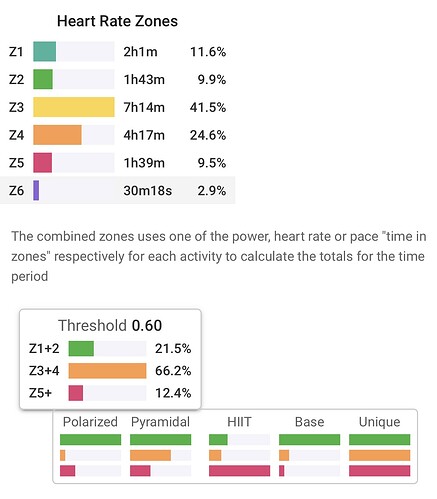

Hello,
In Garmin I have five zones, with Zone 1 lower end at 130 BPM. I would like to setup intervals.icu to match this. However, it seems that it is mandatory in intervals.icu to have a zone with the lower end at 0 BPM. This means that Zone 2 in Garmin = Zone 3 in intervals.icu, which is not ideal, especially as the total time in combined HR zones doesn’t include Garmin Zone 5 (intervals.icu Zone 6).
How to fix this?

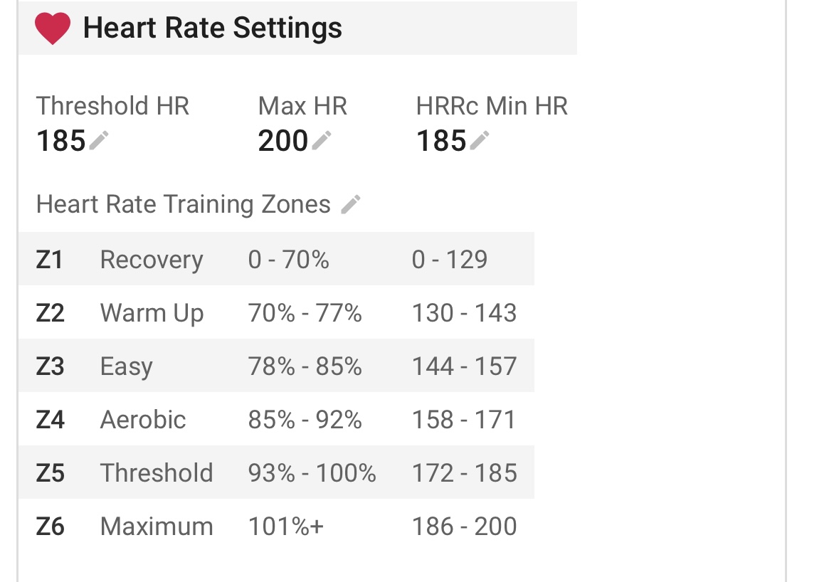

Here is how it looks on my end…

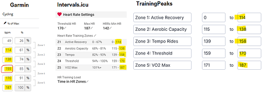

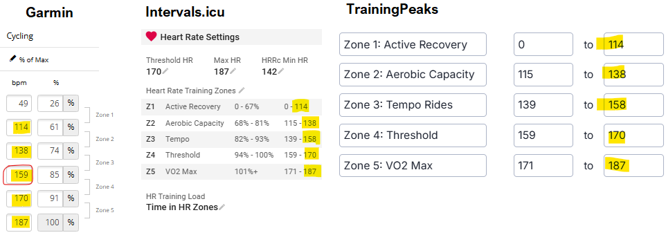

All zones are able to be changed to suit your own individual physiology. This means each zone is the same in all applications. All my applications have the same zone setup, and changes based on certain testing/modelled data.
That said, Garmin Connect doesn’t like me entering 158, and will either use 157 or 159.
@tennisninja, I don’t think you’re the first or the last person to ask this. Yes, 100%, it’s possible to make the respective HR zone configurations match, exactly as @Gerald showed. I briefly went through the same head-scratching as you, perceiving at first what seemed like a misalignment of the HR zones. We can blame Garmin’s UI which doesn’t make this as intuitive as it should be. If you look at Gerald’s screenshot of the Garmin UI, it helps to think of 114 as the end of Zone 1 rather than the start of Zone 2, etc.

To clarify, it’s not an issue getting the BPM of the different zones to match. The issue is with the naming of the zones, because Zone 1 in intervals.icu must start from 0 BPM, whereas Zone 1 in Garmin starts from something above 0 BPM (130 BPM in my case).
If it were possible to rename the zones in intervals.icu then this wouldn’t be a problem; I would simply rename Z1 to Z0, Z2 to Z1, etc.

You could set the top of Garmin Z1 as the upper limit of Interval’s Z1.
