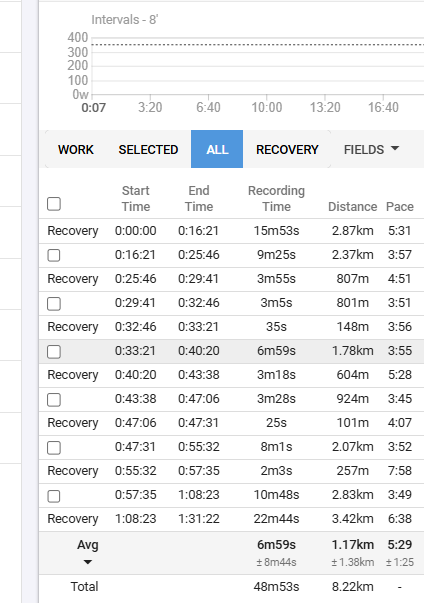

I set up this workout.
But the workout results are like this. I tried all other options from reanalysis but none of the combinations make the end table as it should be from the workout structure. Is this not possible? Or am I missing something?
Thank you!
If you run the planned workout on your device and the lap events come through in the FIT file received from the API, you just need to check ‘Use laps’ in Intervals for everything to be correct.
If the lap events are not in the FIT file (Garmin introduced limitations), you can use the timing from the planned workout, but this will only work correctly if you disable ‘Auto-pause’ on your device and if none of the steps have ‘Press lap’.
Most other cases will cause timing shifts.
In theory perhaps, but when all data is present and included, I can’t get it to correctly display intervals, see Question on FIT file parsing: Misaligned Splits / "Summary First" vs "Summary Last" handling
Stupidly enough, Garmin recognizes them without issue…
