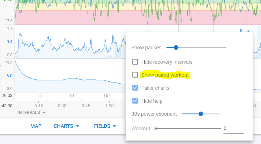

Don’t think you can do that for speed.
But for Power it works automatically. Pair your activity with your planned workout and display target and actual together by checking the checkbox in the options on the activity page.
