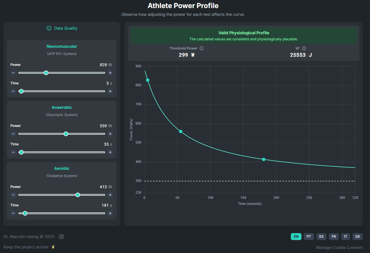

Essentially, it estimates your Critical Power/FTP (I’ll use these interchangeably for simplicity, even though I know the conceptual differences) and W’ with just three ultra-short maximal efforts. I use intervals of approximately 10 s, 60 s, and 3 minutes with great results. I like these durations because they give me a good idea of my three energy systems (ATP-PCr, anaerobic glycolytic, and aerobic oxidative).
To use it, simply test yourself at these intervals. I do all mine in the same 50-minute workout. Just input your data and see your threshold and W’ estimate. You’ll also see how changes in power for each interval affect the threshold estimate.

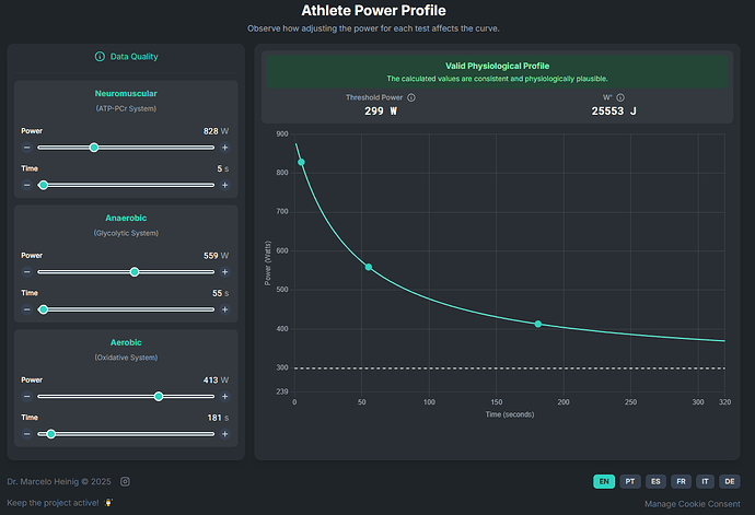

Just for comparison, here are the intervals I did in my indoor test this week (Sorry if some words in the pictures are in my native language!).
Below, you’ll see my estimated CP and W’ using those numbers…
and here… what my Garmin says my FTP is today.
GarminFTP

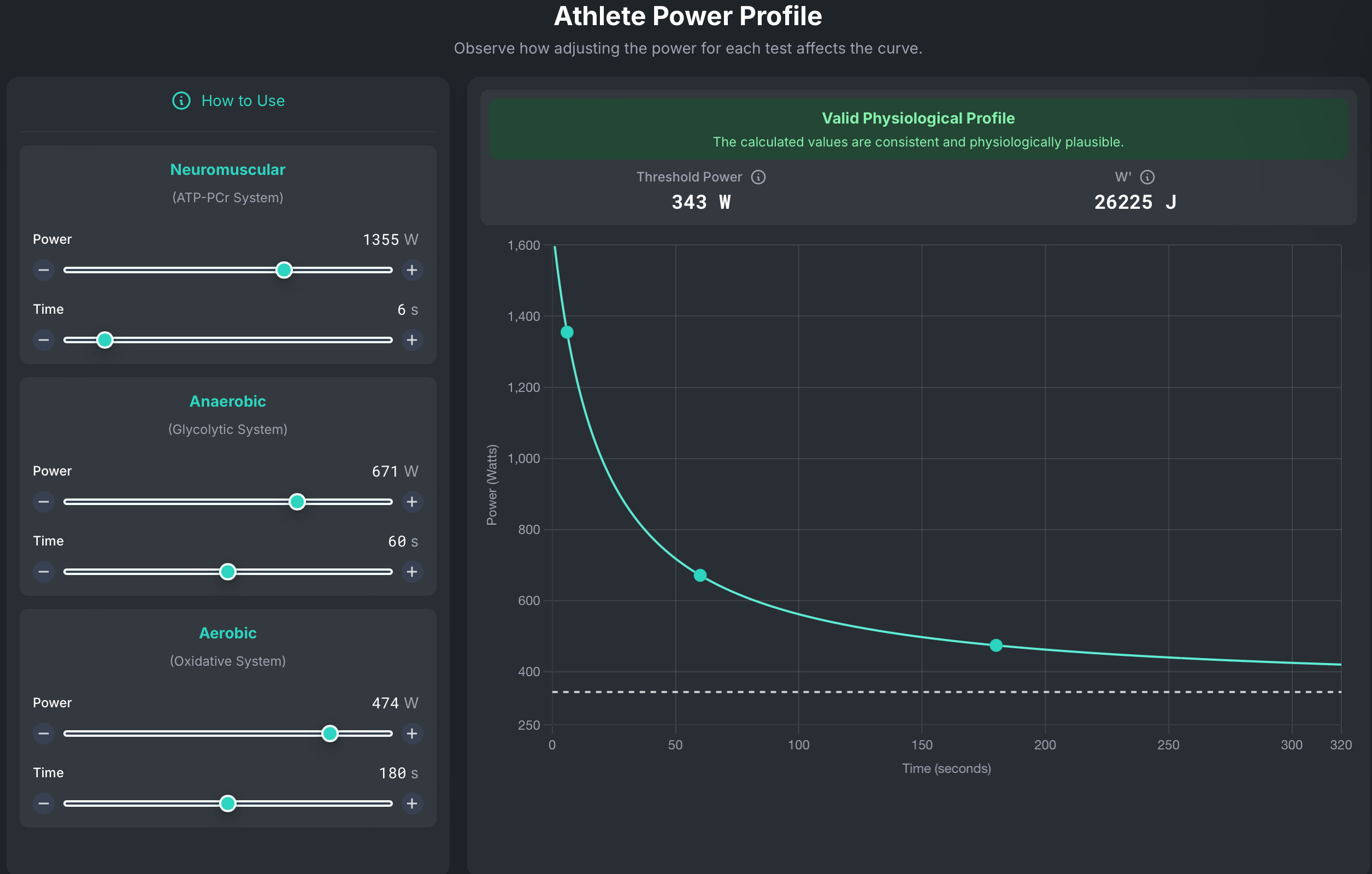

i gave it a try (i hate 20-min ftp test too :slight_smile: ), these are my results:
a bit underestimating FTP in my case: with the same data, intervals give me an FTP of 242, which it is more or less very close to a test i did (237 W butr not the best day on bike) .
i guess it depends on the type of rider you are. a bit overestimating if you are more glycolitic rider, or underestimating if you are more aerobic /longer effort guy. very intersting though, thanks for sharing.

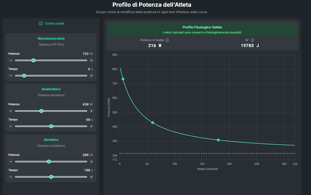

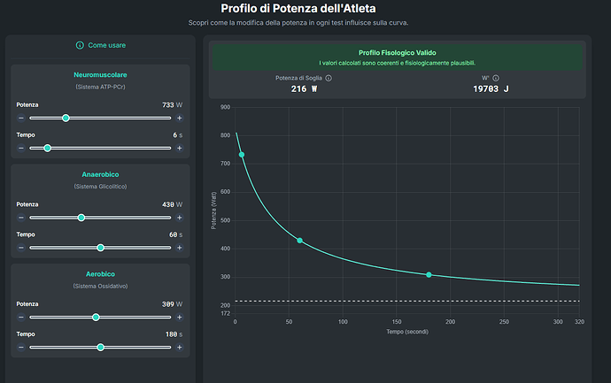

Cool little tool. Is within a percent or two for me with my (slightly old as I hate doing them) 20min max effort based FTP of 335W.
This approach gives me some comfort and enthusiasm to test far more regularly. Is this similar model to the eFTP model that intervals uses?
The tool uses a mathematical variation of the critical power model with 3 intervals (a variation adjusted to work with such short intervals). Intervals has available 2 and 3 parameter methods for the CP/eFTP model (which will not be suitable for such short efforts) and a single-effort method, which, if I remember well what I saw David write years ago, compares your 1-interval effort with an average of curves from a database and from that estimates CP. After estimating CP, it calculates W’ based on a short interval.

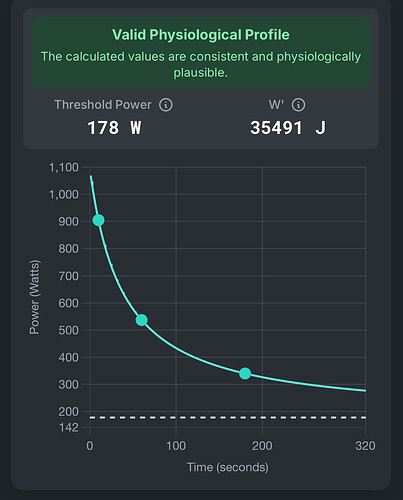

Hmm, first try I get eFTP/eCP that is below my 3 hour power.
Input data:
Is all the data at maximum effort? Especially the 3-minute and sprint data? Even a few watts below maximum has a significant impact on the calculation, as you can see by changing the sliders… reaching maximum in these intervals is something I see as a difficulty for many people.

Red = 9 years ago. CP 272 / W’ 22,620 J / FTP 276. Max efforts out to 65 minutes.
Purple = 2 years ago. CP 268 / W’ 22,800 J / FTP 274. Max efforts out to 22 minutes.
Playing with numbers the best I got from your estimator was ~220 for the 2 years ago data. And as low as ~180 using the known max effort data posted earlier.
Thanks for posting the website.
The tool is quite sensitive because it uses short intervals. If we consider your 15s at 999 watts and 60s at 542 watts, you’d need to maintain 372 watts for 3 minutes. That doesn’t strike me as an absurd power output for a 270-watt threshold.
But this brings up a crucial question: Are those 3-minute interval data point specific to a prior all-out 3-minute test without pre-fatigue? Or were they collected during races or training sessions?
If it wasn’t a specific 3-minute interval test, you might actually be capable of sustaining closer to 370 watts. That would be approximately 137% of your threshold.
I see this all the time. As an example, just last week a friend tested his 1-minute power and the most he could do was 400 watts. I jokingly told him my 9-year-old could do that! He did the test again a few days later and held 475 watts for a full minute. It just goes to show how much more you can push when you’re truly motivated or the test conditions are optimal.
However, if 340 watts is your maximum in a specific 3-minute test, then it’s clear the tool isn’t quite working for you as intended.
Anyway, I really appreciate you taking the time to test the website. It’s only by testing and making adjustments that we truly learn and improve!
