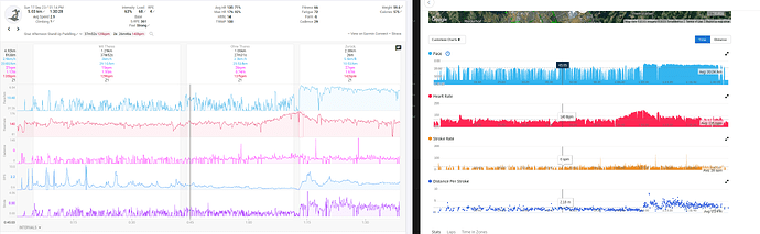

I did a SUP activity with my Garmin Watch today.
GC shows me the Stroke Rate (spm) and the Distance Per Stroke (m).
The Fit File Contains
timestamp,
position_lat(°)
position_long(°)
distance(m)
enhanced_speed(m/s)
heart_rate(bpm)
cadence(rpm)
fractional_cadence(rpm) (which is always Zero)
In intervals.icu I can select Cadence (which is exactly the Stroke Rate)
I can also select Stride, which seems to be half the value of Distance Per Stroke as shown in GC.
I tried a bit to create a new Custom Stream, Distance Per Stroke = Stride / 2, and also to calculate Stride by myself, but both approaches failed.
Can someone give me a hint on how I can get my desired metric?

Thank you for your fast reply and for the code!
That looks very much like the results I am seeing in GC. I termed this new Metric DPS (Distance Per Stroke).
Is it possible to also use this in the interval fields? (I tried but failed again^^)
With this, I could easily compare the exact numbers of the Garmin Implementation.

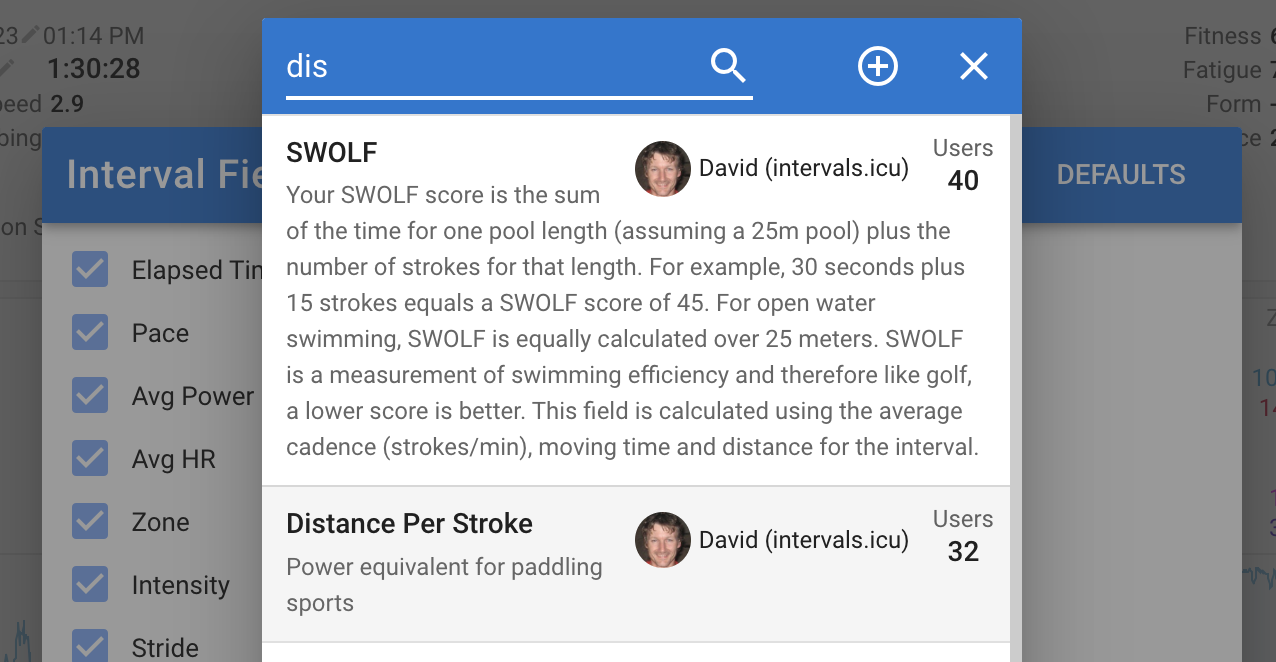

Tx. There is already a custom interval field for DPS:
