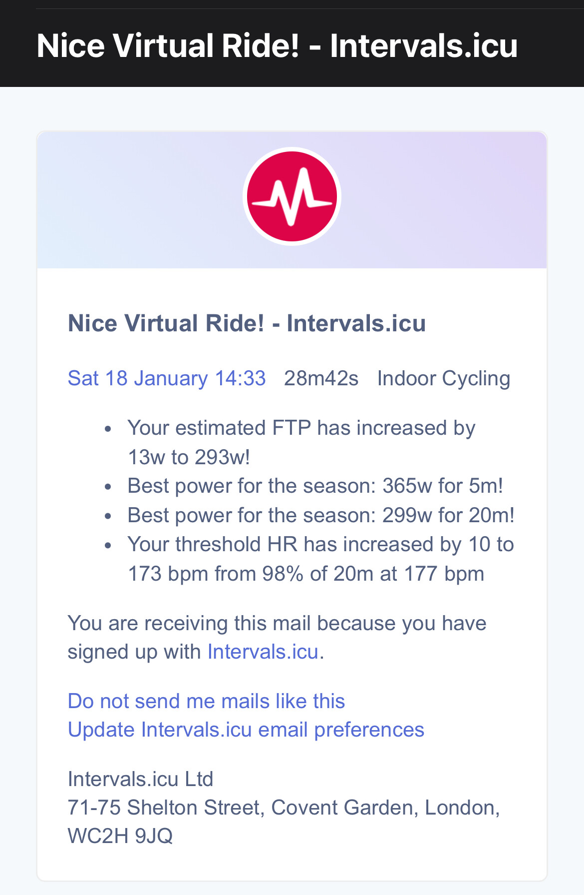

I did the Zwift Elevation Evaluation route yesterday to refresh my FTP. Afterwards, I received this email from intervals.icu, screenshot below. But how is the estimated FTP being calculated?
I thought generally the 95% of 20-minute avg. would be considered as FTP. In my case, it would be around 284w which is kinda what I think is correct but where does the 293w come from?

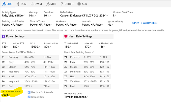

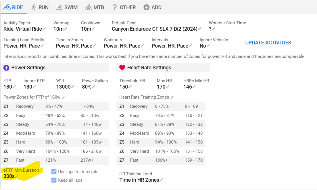

What is used as minimum duration for eFTP calculation in Intervals?
I would advice to use at least 5-6 min for min duration because otherwise people with high anaerobic power/capacity will get overrated eFTP.
You could play with that setting a bit and re-analyse the activity to see how it changes. If there’s a big difference with the default 3 min compared to 6 min, you may have high anaerobic power/capacity interfering with the model.
Thanks for the info! I do think I got over estimated…I tried to adjust the eFTP duration and check the eFTP changes for a particular workout, here are what I got…

I think my ftp (measured on pedal) is around 282-ish…so what eFTP duration should I use then?
If you plan to test regularly with longer all-out efforts, set minimum at 12 minutes or longer. But do remember that efforts shorter then what is set will not yield any result.
FTP estimation within about 10 watts is accurate enough. Don’t forget that FTP is not a static number. It changes day by day with your fatigue/mood/stress etc…
And you train in Zones, not to a fixed number. As long as you’re in the right zone, you’re training the right target.
Understood, thx!
I set it for 10min for now.
