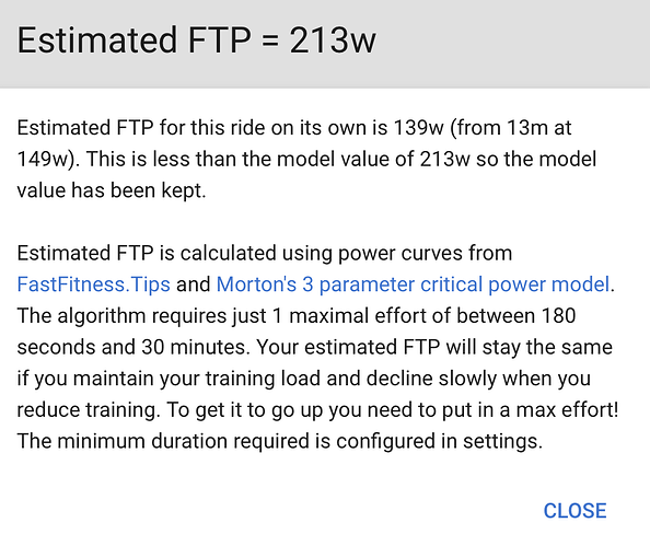

on a cycling activity, click eFTP at the top of the page (upper right) and I get this:
with a link to a paper on Morton’s 3 parameter critical power model.

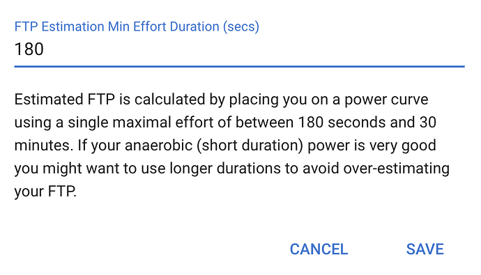

on the Settings page, you have some control over the algorithm:
its the “eFTP Min Duration” setting under the Power Settings / Zones on the Settings page.
