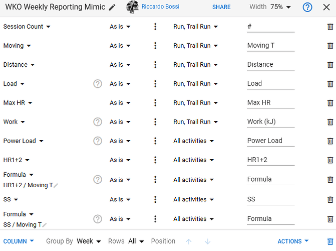

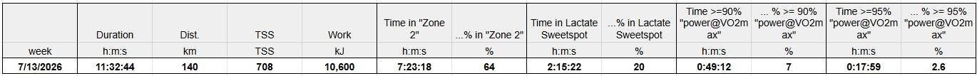

Trying to mimic a weekly report shared yesterday Steve Palladino on Facebook. Below is made with WKO and wondering if Fitness Totals page could display the same. I made a start but did not manage to get all the metrics lacking formulas and data.
Thanks for the help :slight_smile:
I took a Totals table as starting point from one made by @RiccardoBossi kudo to him. The custom formulas are not working.

Goal indeed is to try to replicate the screenshot which is actually a WKO screen.

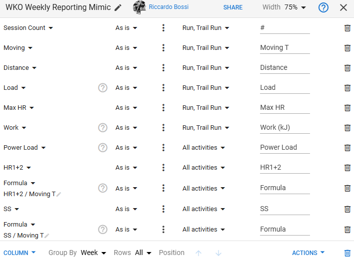

Hey !! Problem solved
Sorry for the delay but I’ve been very busy last few days.
Anyway it was a data aggregation problem when working w/ the formulas. Had to read a bit about it in the bug reports but now it works !! Just tell me if you need it w/ hr z2, power z2 ecc..
It is just available on my profile. BUT with a few differences.
  1. I do not have a subscription so I’m not able to make custom zones, and I cannot make the last two columns due to that. I’ve made a column with time in and over z5
  2. Make sure to have in your settings the “power, pace, hr” as setting to calculate time in zone if you want to see time in zone based on power in totals table. Otherwise you have to change the formula.
