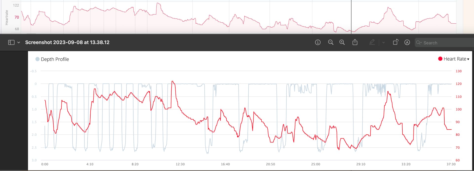

I checked my last activity and the HR I see on ICU seems to match what I see on Garmin Connect (this is the Apnea activity type from Garmin)
