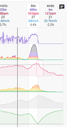

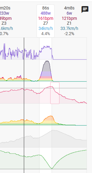

I’ve been getting strange HR wobble for well over a year when emptying W’ after max anaerobic efforts. Usually hill climbs, ranging from 1 min to 4 min out of the saddle.
My HR ‘pings’ around max and sometimes oscillates/jumps up and down during recovery. I can’t feel anything strange at the time other than being very out of breath and desperate for recovery.
I’ve seen a cardiologist and had stress tests and a ultrasound and they were unconcerned, but couldn’t replicate the issue on a treadmill.

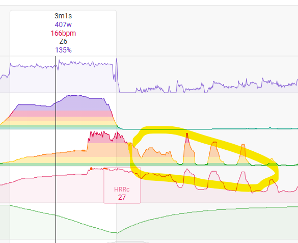

Could it be caused by moving from standing to sitting position? Would be very interested if anyone has similar HR plots? Normally my recovery is nice and smooth. (p.s I’ve tried different chest HRMs and an Optical sensor and they all show the same plot)
Screenshot 2024-11-27 111450

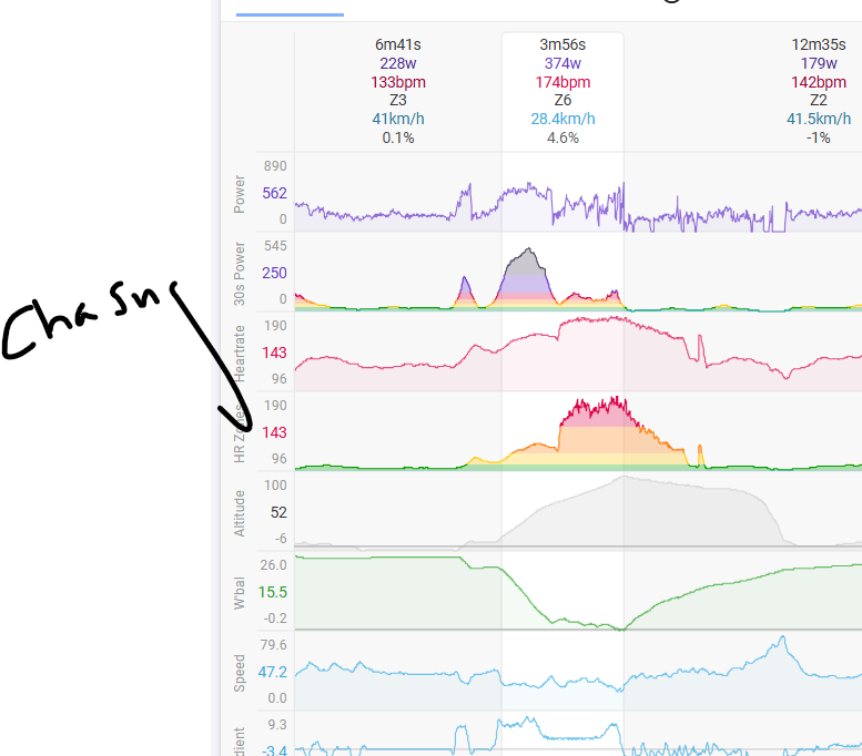

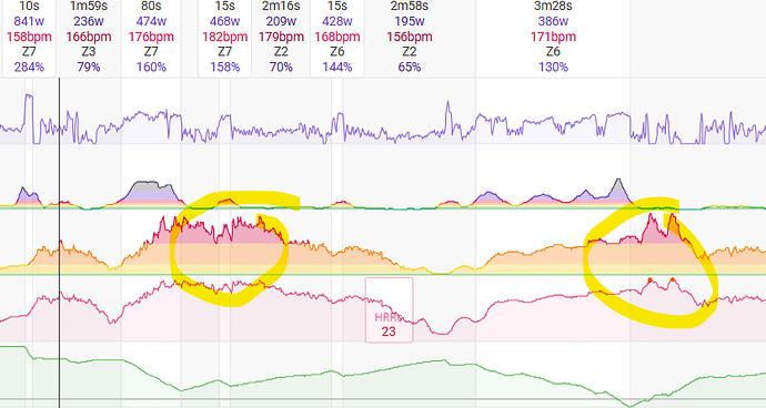

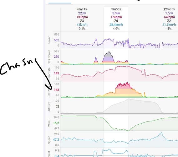

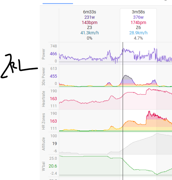

I’ve seen one and had an ultrasound and they couldn’t find anything. But when I empty my W’ through an anaerobic effort I get a 20bpm spike to almost max HR.
These are two efforts on the same route 3 months apart, note the 20bpm jump.
This tends to happen on the first big emptying of W’, on subsequent intense efforts the recovery is smooth and normal.
