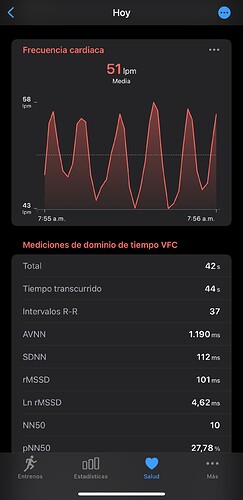

I just wondering if when syncing from HealthFit, files brings hearth rate measurement when import HRV data (rMSSD, SDNN, etc…) I can see on HealthFit app the hearth rate and HRV data measured manually (mindfulness) with Apple Watch (via breathe app on it).
As you can see my morning HR was 51, but the synced RHR from Healthfit is 43 (yesterday’s RHR), it does not work for my trending analysis.

On the calendar view, click on the date portion of a day. There is an option for Wellness Data, click on that. Manually enter which ever HR you want to use as RHR. There are also fields for HRV (SDNN) and HRV (rMSSD)

Avg during HRV measurement is generaly accepted. I´m using Kubios for both HRV and rHR in the morning.
The most important thing is consistency.
HRV4Training gives you the value, which for me corresponds to the avg of the measurement’s time when checked.
I am not scientific but for me, most importance here is consistency, there is a difference in resting HR and sleeping HR, so for my training I use my morning HR (after sitting up using the protocol) as my resting HR.
