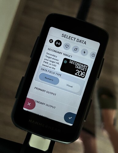

I arrange structured workouts in intervals.icu. I keep my account synchronized with Karoo. Everything works fine, but I don’t know what I need to do to have the set cadence displayed as “Secondary Target”. It seems that Karoo does not see cadence as a second target. Is it possible to fix this somehow? Thanks a lot
do you know if the karoo actually supports this?
@app4g Hi! Karoo has a field that is called “Secondary Target” so it tends to support that.
