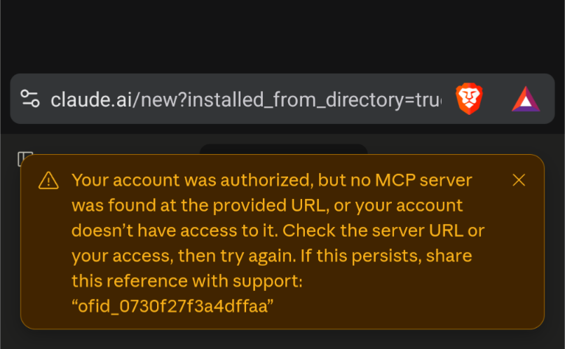

Using Claude app on Android, I don’t see this in the list of connectors, am I missing something?
Here’s what I see after oauth completes
Never mind, initially i had the mcp address in as simply mcp.gregaria.app, Only visiting that website did I get the full mcp url:
https://mcp.gregaria.app/api/mcp
