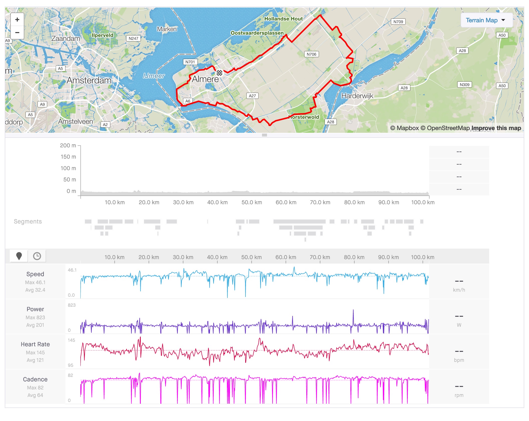

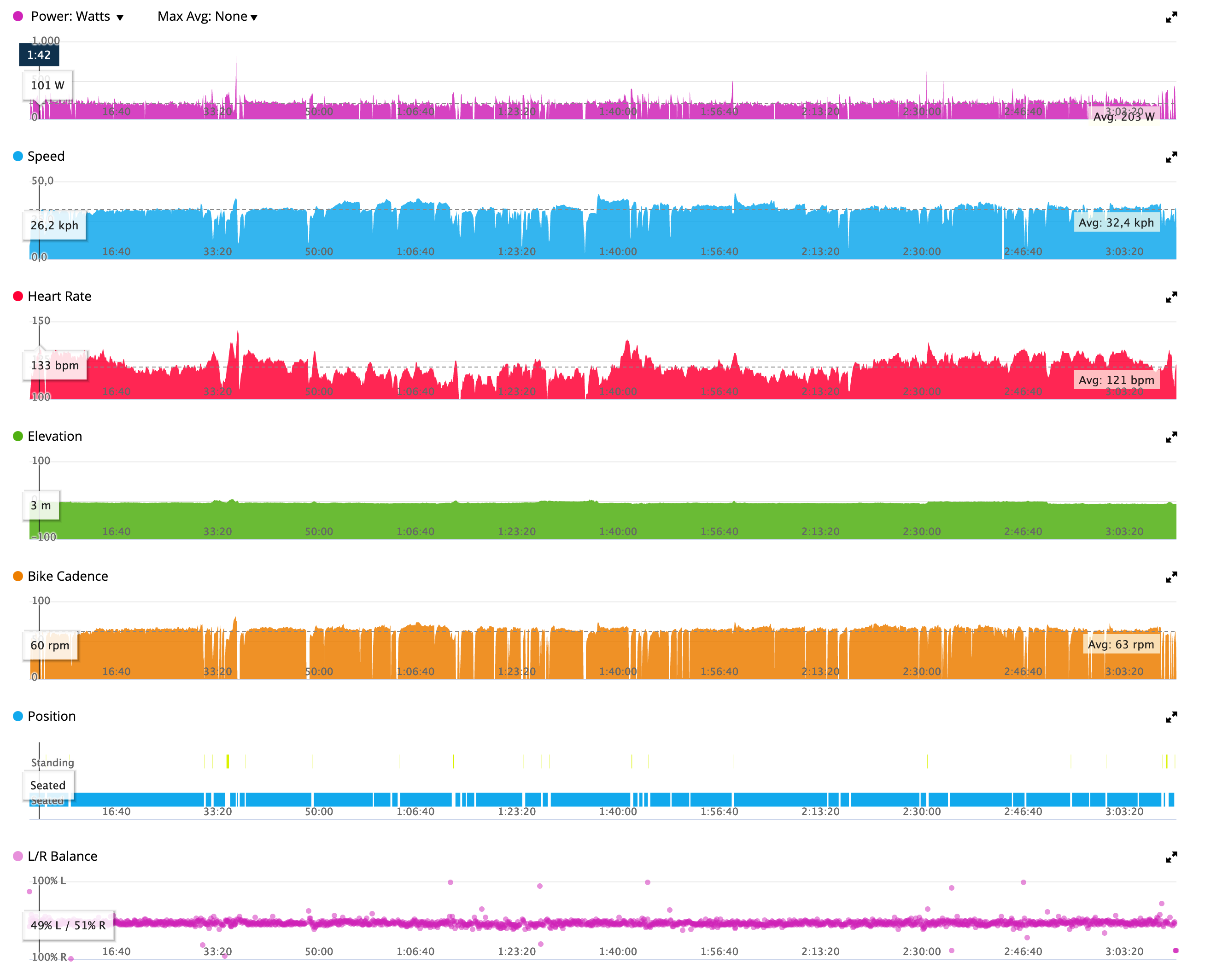

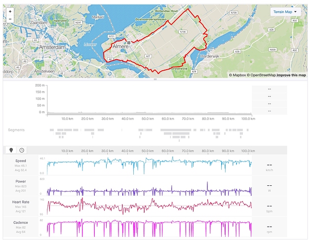

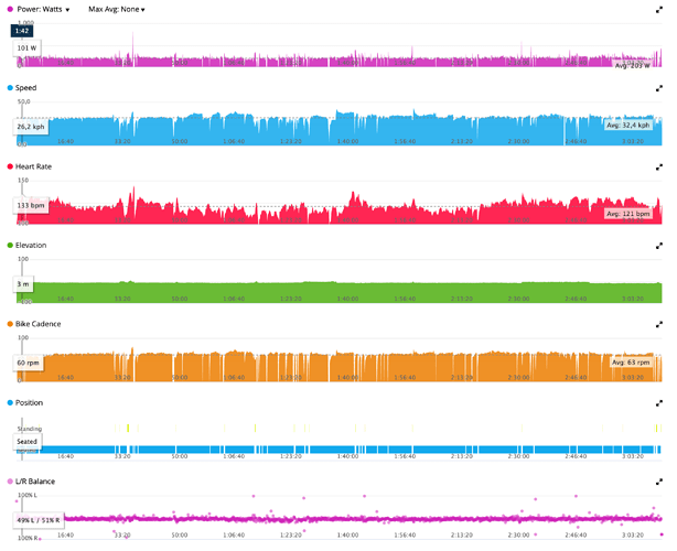

No, because Strava records only one stream, i.e. L and R combined, so that’s all intervals.icu can show you. If you have a Garmin device (not sure how recent that has to be, but I have an Edge 530), then you can see that L/R balance on Garmin Connect. There may/must be other cycling / sports devices that can capture L/R balance, but if you upload to Strava only, that info gets lost…
