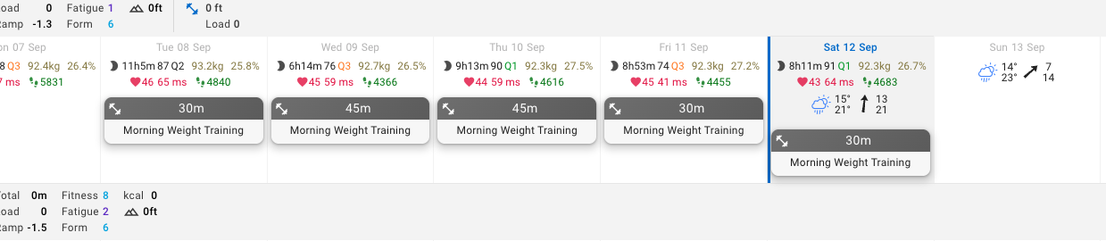

In fact after correcting the data earlier. i just checked NOW and intervals has reset , it has changed correct data to exact same data over few days see attached
