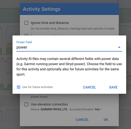

You can go to Actions → Settings for one of your runs with both power sources and change it there. Its not very user friendly yet “Power” vs “power” but does work. Future runs will use the selected source.

I just add this issue due to a new watch, the Power is from Stryd, power is from Garmin
I also turned the power option in the running activity to accessory only, will see if this removes the Garmin Power from the FIT file
