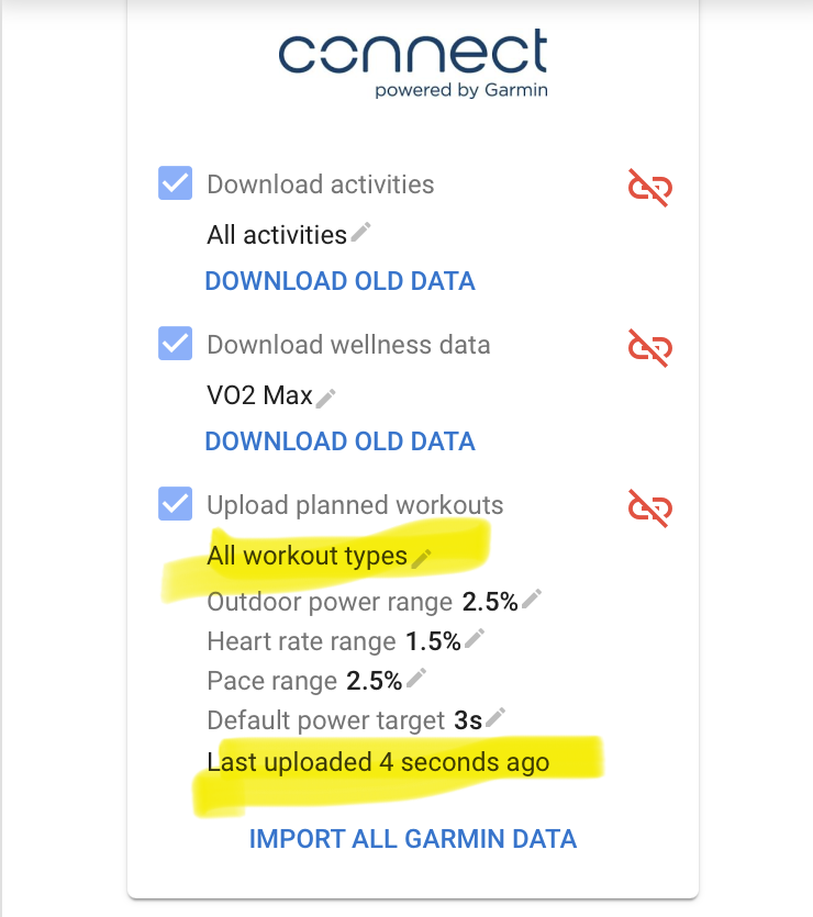

What is your upload state? Any filter?
Please show a screenshot of the workout. If it’s wrong syntax, it won’t upload.
For legacy reasons that are hard to fix, Intervals.icu uses two Garmin Developer apps, one for activities and wellness and another for uploading planned workouts. So it is possible for one to work and not the other.
@Marilou_Dumont I checked the logs and your stuff is uploading without errors, both before and after you re-connected. So I am not sure why you aren’t seeing anything on GC.
