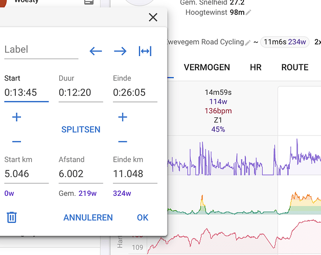

Here is the situation.

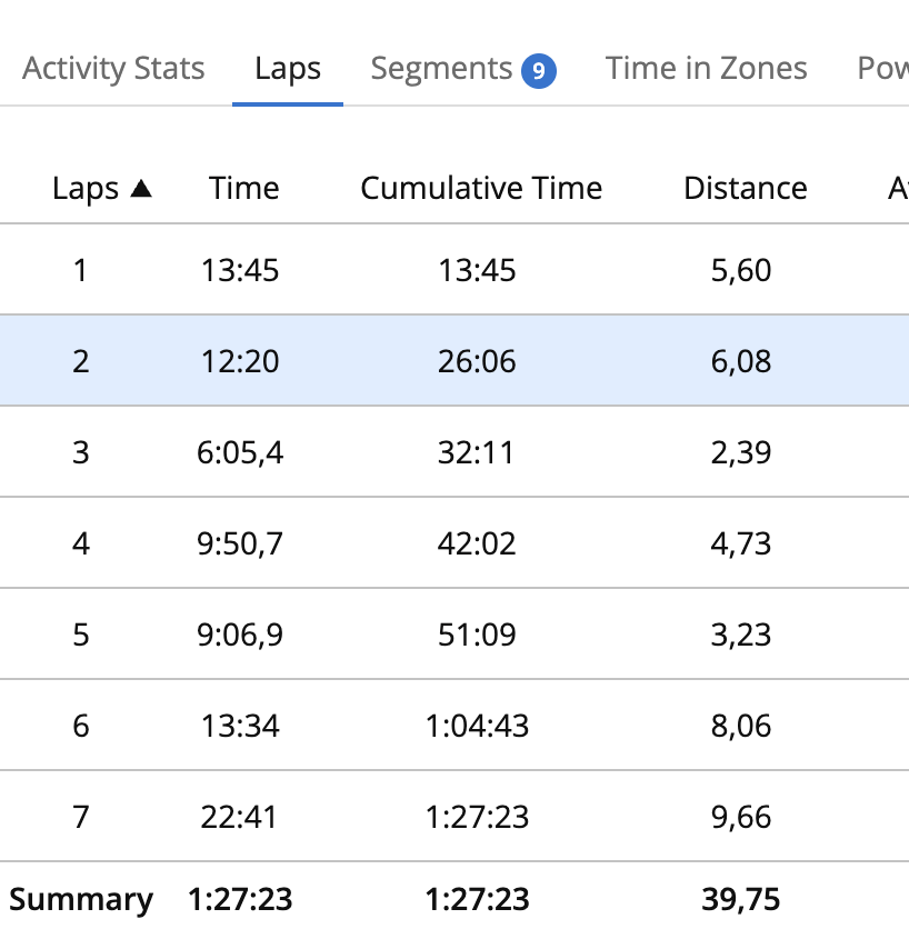

I did a ride and manually pushed the lap button on my garmin to mark my laps.
If i use the time data from garmin to fine tune the interval on intervals it’s not correct.
What am i doing wrong :smile:

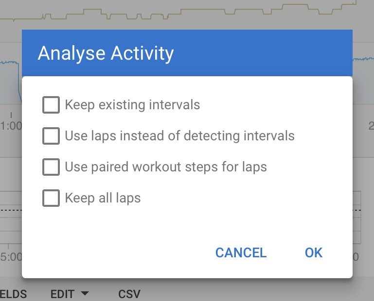

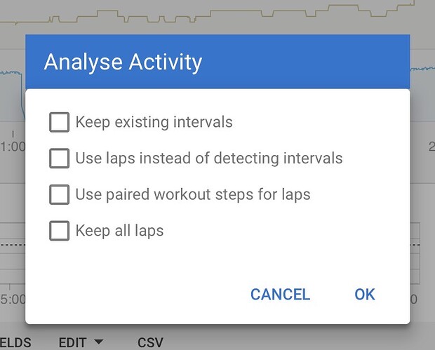

First try the options “Use Laps” and “Keep all Laps”. (Action menu and settings page for future activities)
i thought so sorry.

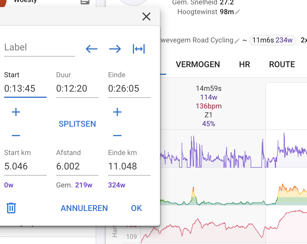

I found both settings. But according to intervals i started my lap at 15min and on garmin on 13:45
(used the use lap option in the activity setting & re-analyzed)
Looks like you are comparing elapsed time (intervals) vs moving time (garmin), because I see there some breaks in the charts.
oh Lol. that solves it :upside_down_face:

before i changed the option to use the lap info from garmin, intervals was like auto detecting intervals. i guess based on power. When i did some climbing he mostly made a interval from that climb.
Not the biggest problem since we can make them like you suggested. I was wondering if intervals can do this auto interval detection thing on command, so that you ‘overrule’ the setting to look at garmin laps
You can choose to use always the use laps option if you enable that in the settings page (below your ftp setting), if this was your question.
