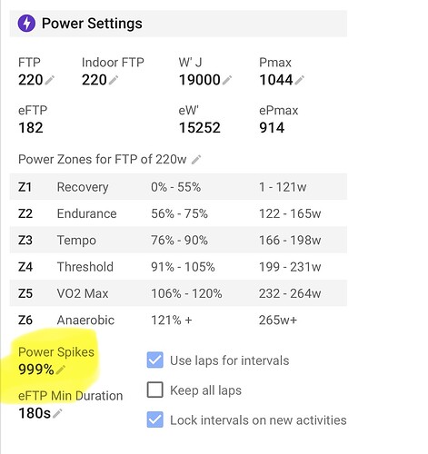

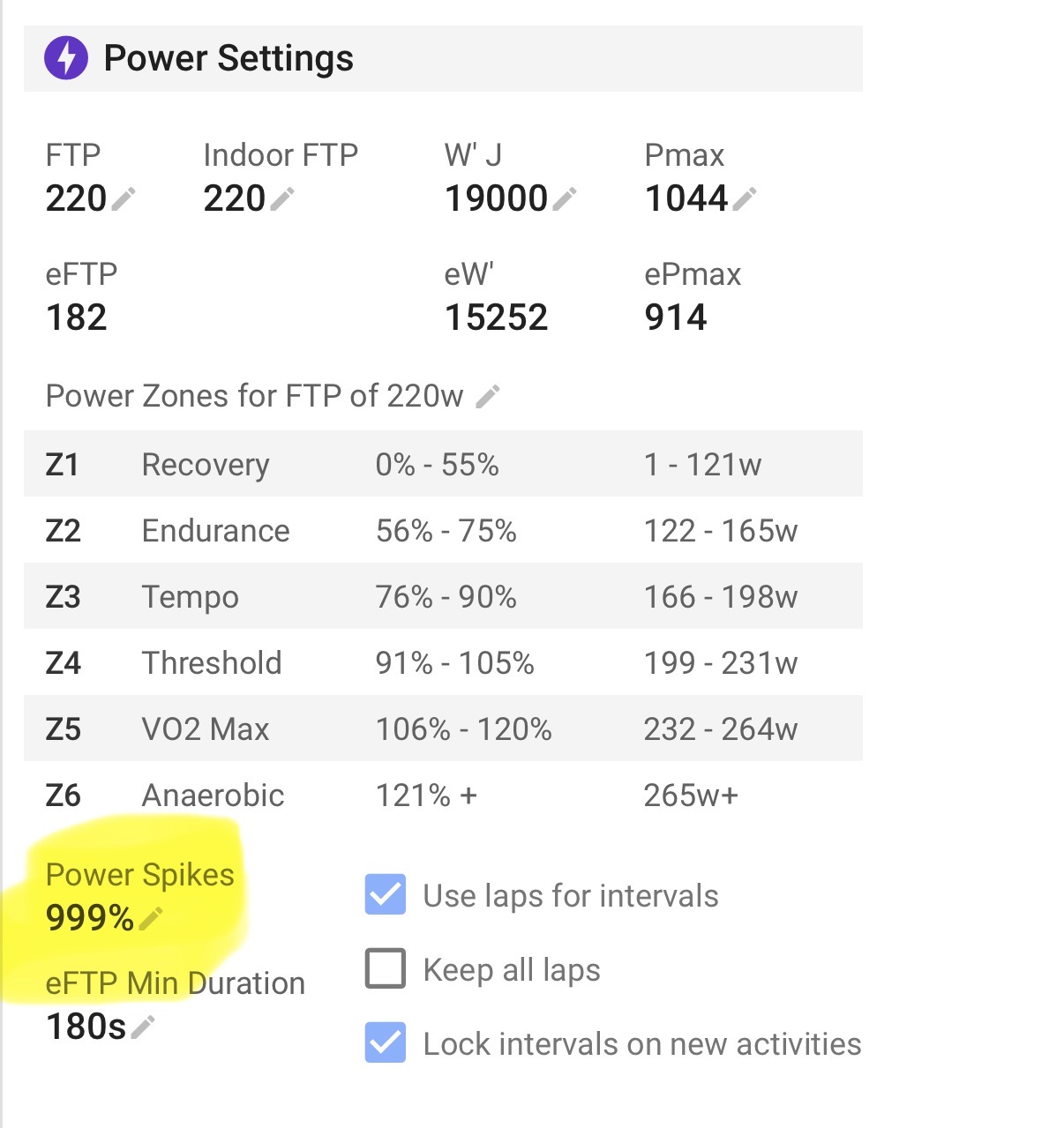

Possibly because Intervals does “power spike detection” which in my experience is wrong. So I turn it off in Intervals by setting to 999:
That doesn’t make sense, it seems you compare different activities - can you tell the kJ for those? Because 190w x 4.5h = about 3100kJ.
Thanks but I altered it and reprocessed the file but it stayed at 1437kj.
