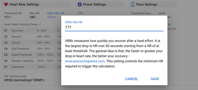

You can set the min HR for the HRRc calc in Intervals.icu in /settings. If you make this low and let your watch continue recording and the end of your workout I think you will get a similar number which is already plotted etc…
yep makes sence, I will set it lower and give it a shot.
