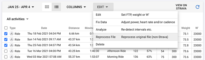

Tx. It’s deployed now. You can fix the broken activities using the list view and “Reprocess File”:
