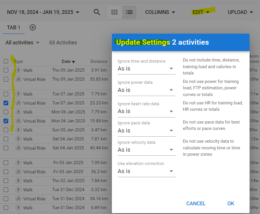

This one is easy to solve:
  • Activity List view - You only need to modify the last 8-12 weeks because older ones have very little influence on the Fitness graph. At least 6 weeks but probably a bit more to get rid of the overestimated Fitness
  • Select the ones that you don’t want to influence Fitness/Fatigue/Form. Basically, don’t modify the one which has the most representable Load but do modify the other one or two.
  • Click on Edit - Update settings and set all to YES except the last one (Elevation correction)
