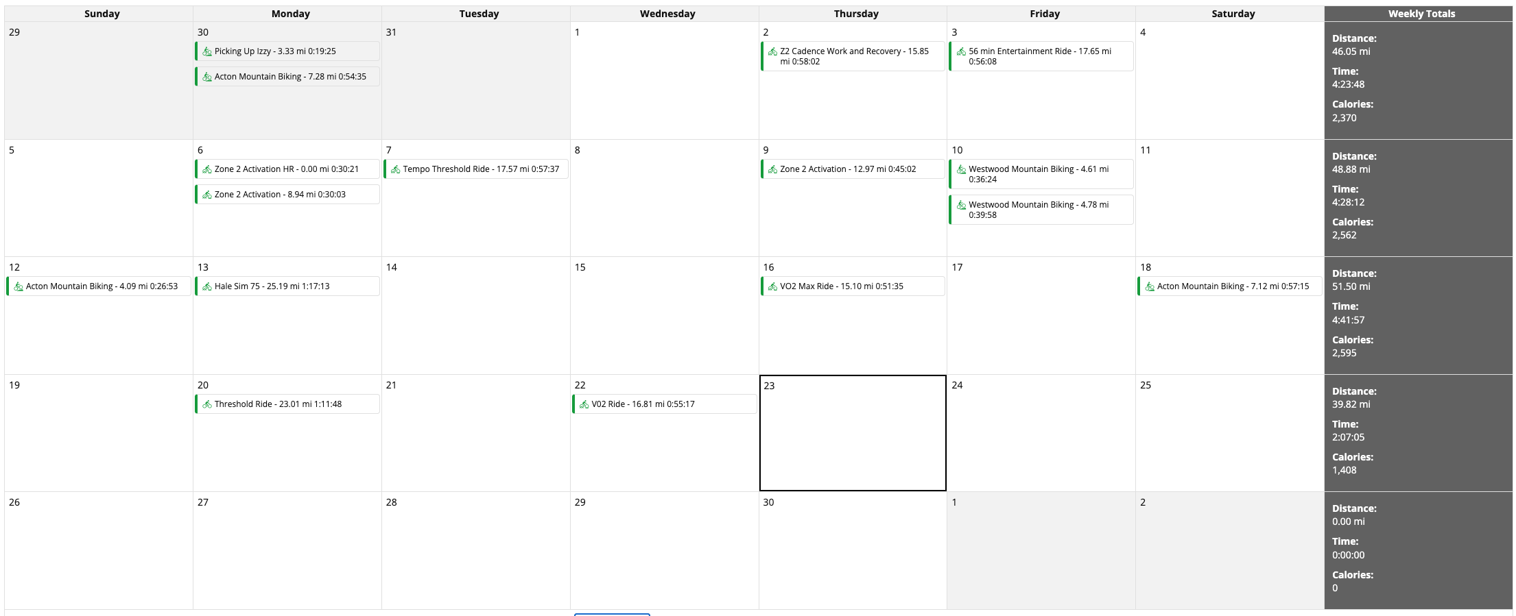

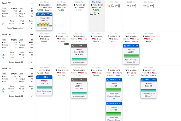

Here are screen shots of the Intervals.ICU and Garmin Calendar. Why didn’t my activity from last night sync yet?

There are several activities that have synced from Garmin that were recorded on the Peloton. Including the activity on April 20th.
Your’re right @MedTechCD. I connected Stravat to intervals.icu. My strava is connected to my Garmin. Now I see the missing activities! :person_facepalming:
