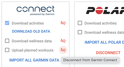

I got his credentials on Connect / Intervals and tried to clean up and reconnect the whole thing again. The old activities are coming through now. However… it’s not uploading the new workouts. I tried to disconnect / reconnect, and the error persists. Any clue?
It seems you need to disconnect and re-connect the “Upload planned workouts” part of this. Garmin has different sets of tokens for downloading activities and uploading planned workouts.

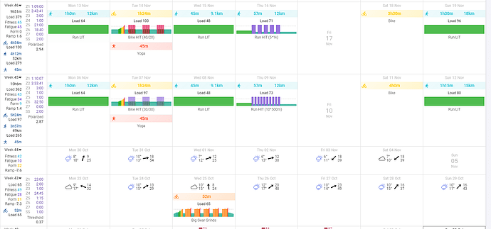

I seems, however, that i do somthing wrong when putting workouts in my calendar.
All these workouts (image attached) are not retrieved by GC. (And even you can’t see them in I.icu.
EDIT: I figured that GC grabs only workouts from a defined period (maybe the week ahead). Thus, I just have to be patient. RIght?
Yes it is approximately the next week to avoid cluttering the device with loads of future workouts.
