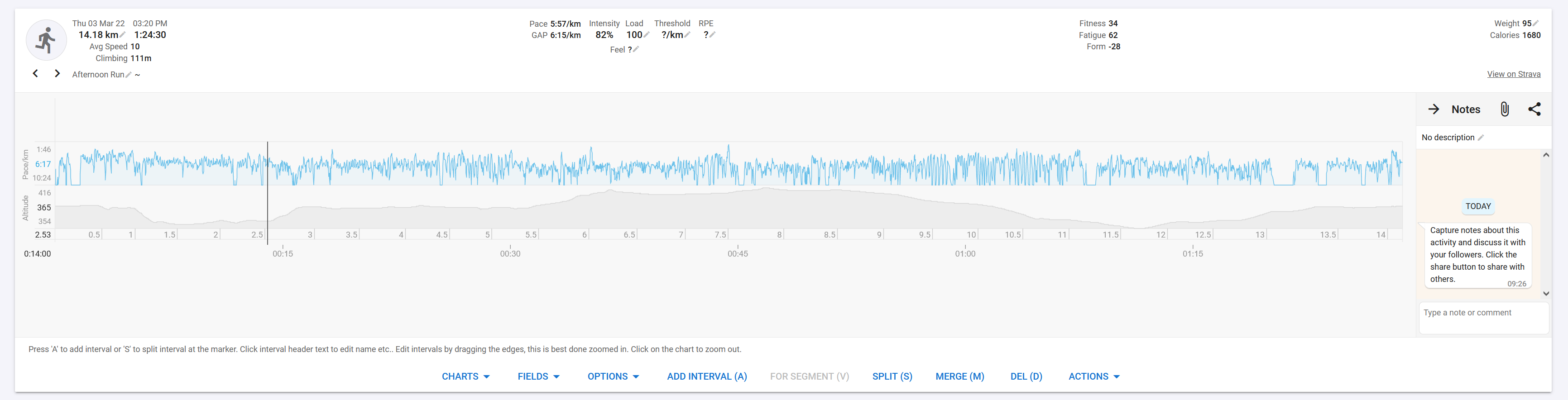

GAP being slower then measured pace
This doesn’t make sense to me. How is the GAP slower than the actual pace.
Please correct me if my train of thought is wrong here.

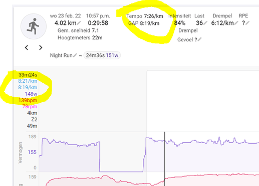

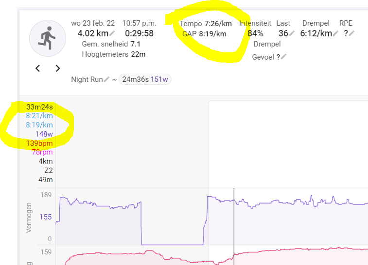

What if you select the entire run? My guess is that GAP and Pace are quite close.
The explanation would then be that selections are handled the same way for Pace and GAP, including stopped time while in the overall calculation, Pace excludes stopped time and GAP includes it. See image below where I selected the whole run.

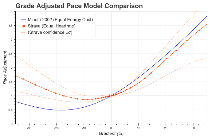

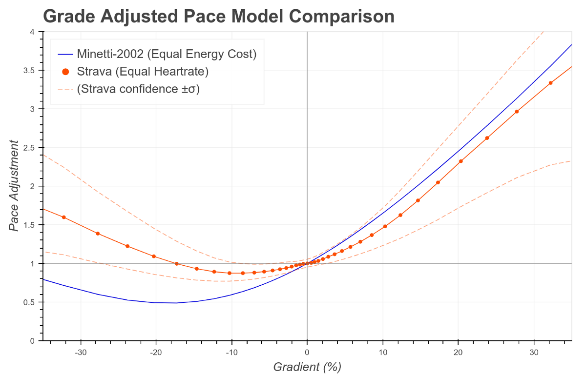

It can be slower than actual pace if you took it easy on the downhills. Intervals.icu uses a model similar to Strava for GAP:
Did you check this?
For me GAP is usually a decent amount slower than actual pace and does not match strava’s GAP.

Sorry I missed that. GAP should also excluded stopped time. I will have a look at that as soon as I can.
You are correct. GAP is including stops. I have updated it to exclude data with pace less than 1/10 of the average pace for the whole activity. Your run on the 23rd Feb now has GAP the same as pace. I checked some of my wife’s runs (up steep hills) and her GAP improved a little.
