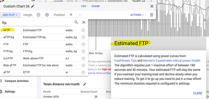

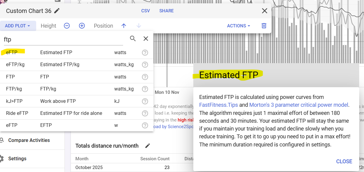

No, the model value is what has been detected in the past from high efforts and then a decay factor is applied. The decay factor slowly reduces eFTP untill a new effort is detected higher then the model value.
Easiest way to visualize this, is by plotting it on the Fitness tab.

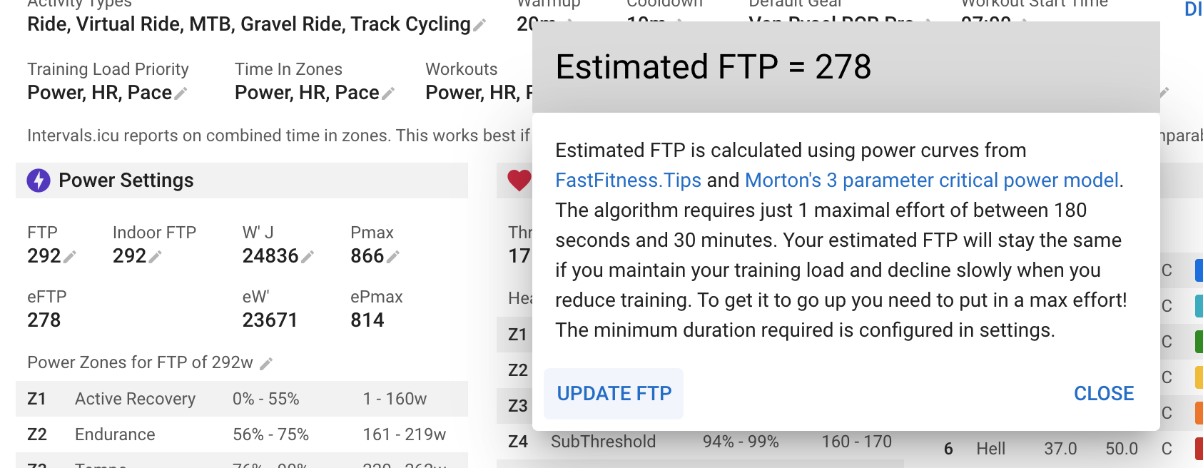

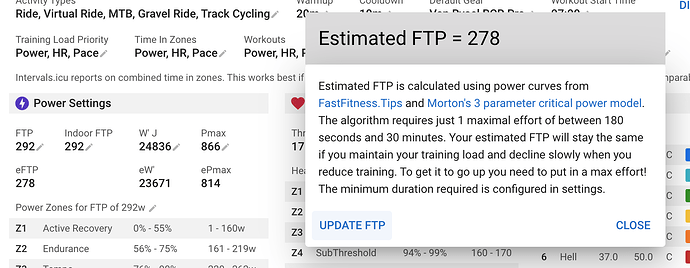

You can also easily make the model values your current settings for the sport on the /settings page. Just click the estimate and then the update button:
@R2Tom Thanks yeah - of course. I understand and am happy with that trade-off. Cool that you can write your own script - will definitely take a look at this!
@david - thanks for noting re. updating FTP. Is that kept live then i.e. will it always use the model value as it changes vs. me having to keep remembering to update (this is the key thing I’m asking for, really).
No, it will not. You will have to update when a change is detected.
