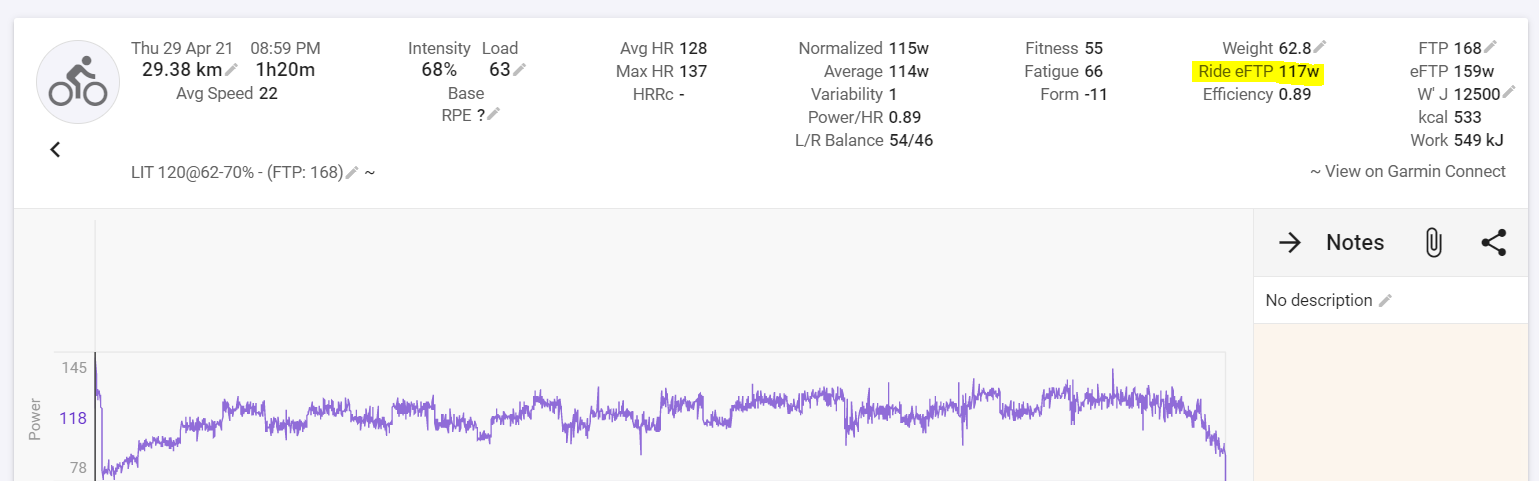

Are you looking at each Ride eFTP on the activity or at the eFTP on the Fitness page?
Each ride will have a “ride eFTP” but if there are no maximal efforts during this ride, this is meaningless.

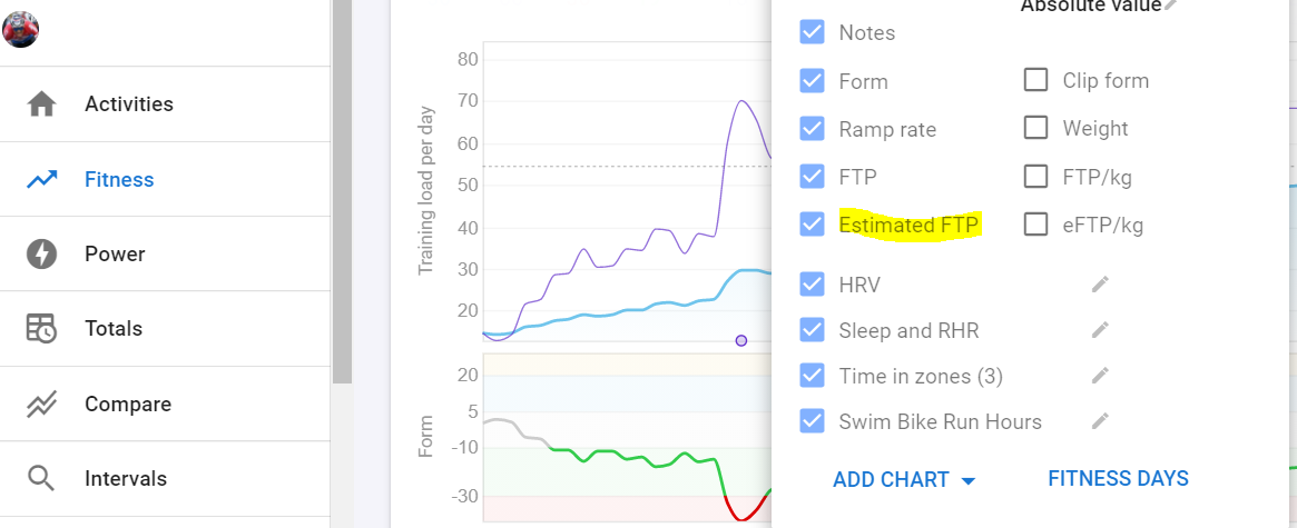

@MedTechCD has it about right. Probably you have an old activity that really bumped up your eFTP and it hasn’t decayed much since then. You can find it by looking at the dots under the fitness chart or by turning on the FTP chart. Maybe the power for that ride is dodgy or maybe you just need a longer min duration for max efforts for eFTP.

Activate the eFTP plot on the Fitness page to track improvements.

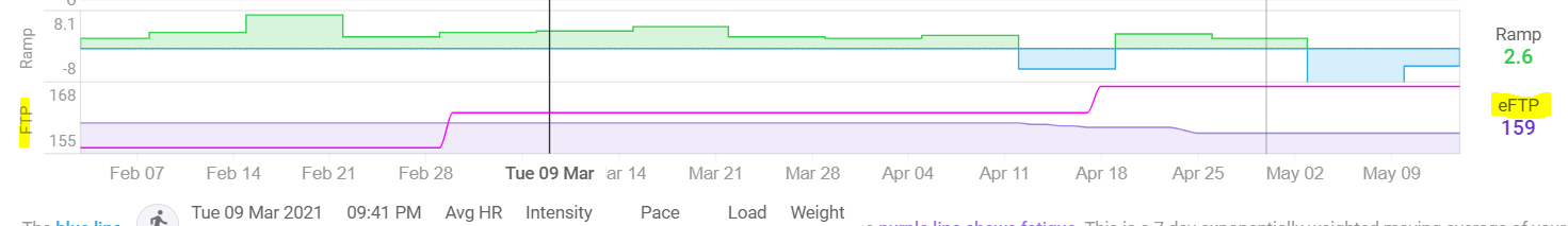

Then you will see this trace
FTP is what you set manually in the settings. eFTP is what intervals detects. Only eFTP’s higher then the actual number will update the trace and it will decay if you have a longer inactivity period or when you don’t do any high intensity efforts for a while as in this example.
