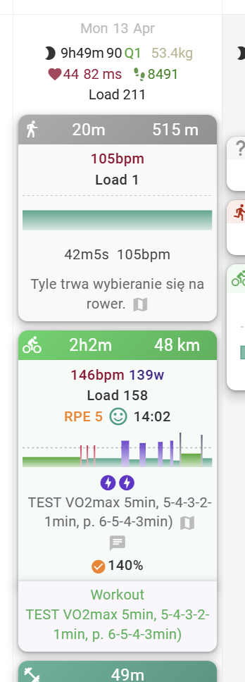

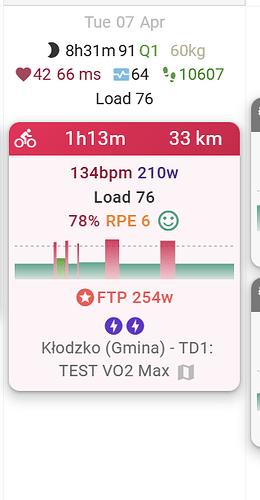

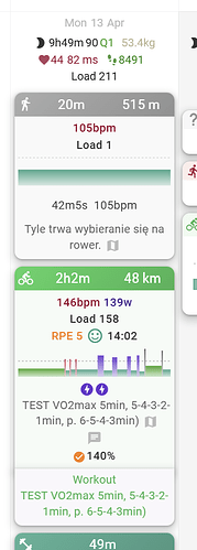

My boyfriend did a 5min VO2max test and got an FTP estimate calculated from it. I did my workout with a 5min VO2max test and did not get an estimate from Intervals. How do I get it? Can it be turned on, where does it come from?
Garmin bike computer gave me an estimate on the summary screen after saving the ride but the info from there is nowhere to be found. It is my best effort for 5min ever (also using a power meter for about 8 months, an indoor trainer for two winters and there was no so good a result as this one - not by a lot, but still best ever), I also have seasons set and that could mean something.

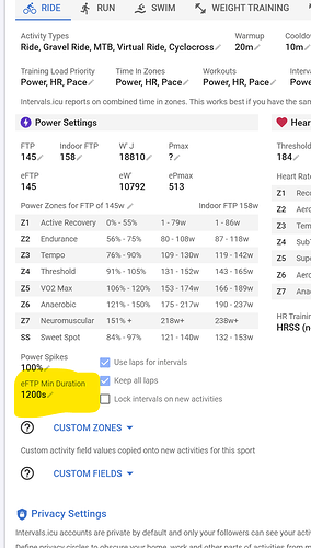

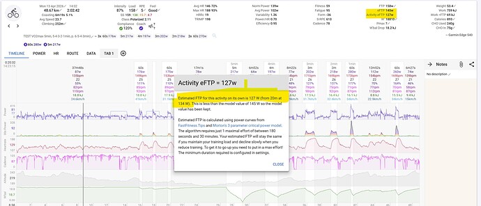

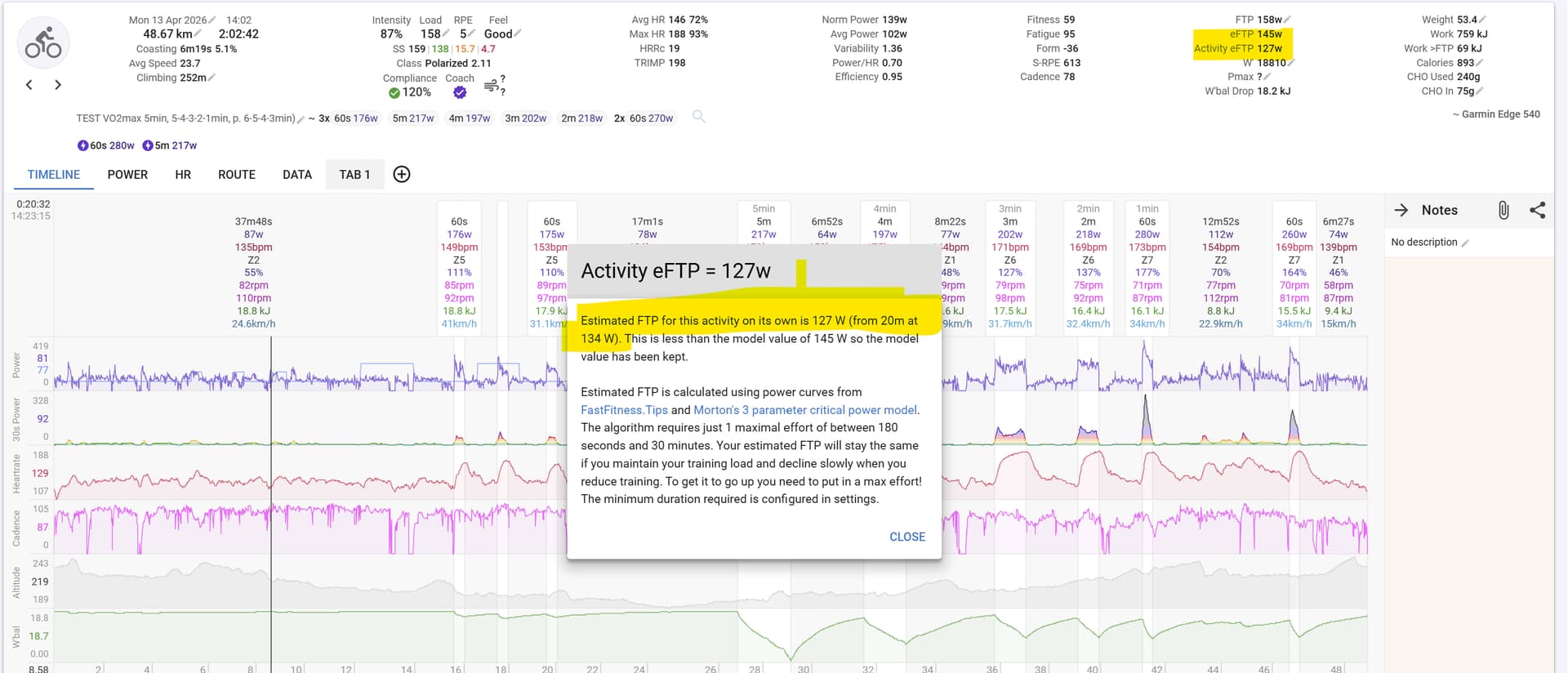

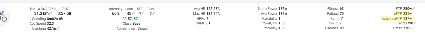

Go to the activity, and you’ll see on the top right eFTP value and Activity eFTP value. You’ll only get the “new eFTP” achievement, if the Activity eFTP is higher than eFTP.
So your last “eFTP” value was higher, so you didn’t get the achievement. Hope that make sense.
Okay so, if this is what it counts then this is not what I’m asking for… the eFTP here is 145, from the group ride a month ago I got 147 so, idk, let’s say I’m so shitty with my training that it fell by 2 in a month. The “activity eFTP” is entirely inapplicable here - it takes the estimate from 20 minutes. I want it from 5minutes because I made a 5minute test effort. I didn’t do a 20minute test effort. It was an interval training… I did hard 5mins, took a break, hard 4 mins, took a break etc. and the “Activity eFTP” is taken from 2mins riding hard + a 4 minute break riding very easy + a 1 min effort (last interval) + almost 13min ride home where I had to overtake a couple times + a segment effort for 1min. This is not reliable data. My actual tested 20min FTP was 158W (based on 166W avg in 20min).

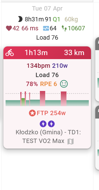

My boyfriend’s example below:
, it says it counted from 5min @ XYZ. I’m cross-referencing this calculator that for his results gives perfect estimates that match the Intervals’ estimates.

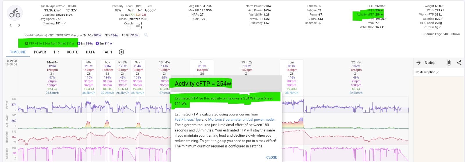

That isn’t a fix calculator. It models a power curve. You found the popup, if you read it, it states:
Estimated FTP is calculated using power curves from FastFitness.Tips and Morton’s 3 parameter critical power model. The algorithm requires just 1 maximal effort of between 180 seconds and 30 minutes. Your estimated FTP will stay the same if you maintain your training load and decline slowly when you reduce training. To get it to go up you need to put in a max effort! The minimum duration required is configured in settings.

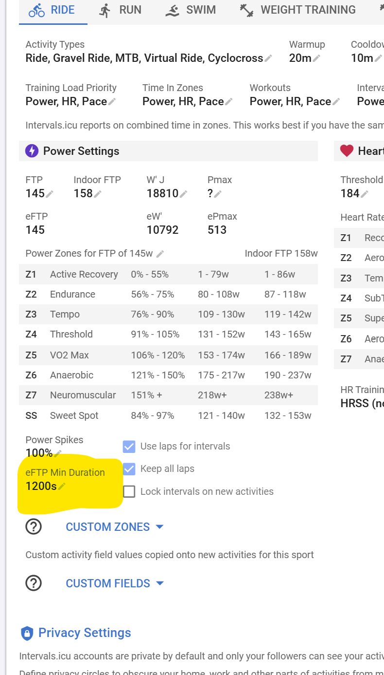

So either, you increased the minimum duration to 20min in the settings (so that it doesn’t use less duration), or it wasn’t “enough” power to change the model to increase the estimated value.
Okay, I found this… I set it to this myself last may after a 20min ramp test.
