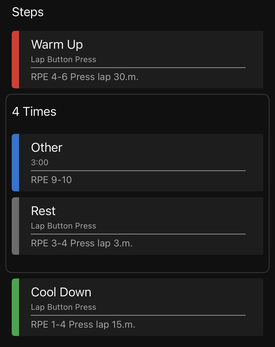

Workout in Garmin (the blue “Other” should be “Run” since the intensity is “interval” - same thing happens for intensity “active”):

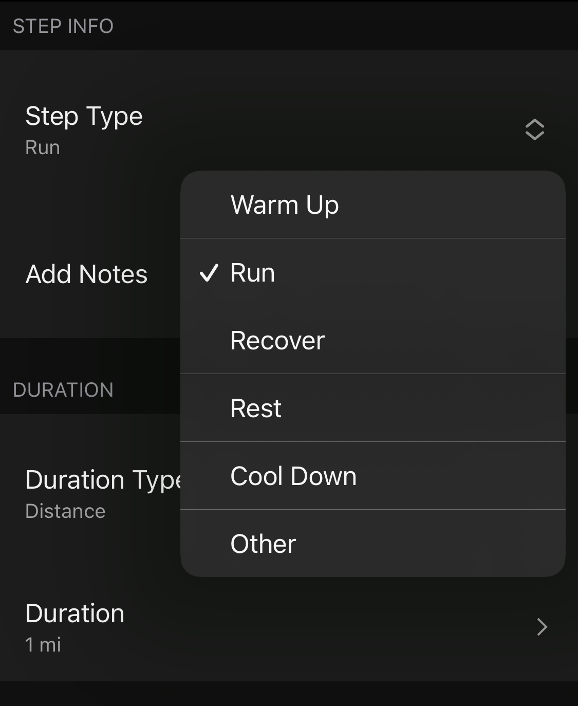

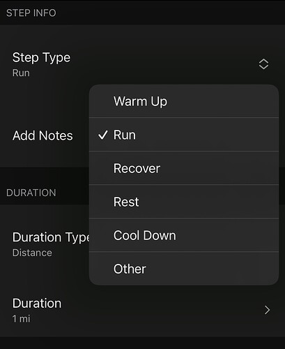

Here are the list of step types in Garmin:
