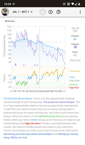

I use Trainerroad and have the workouts scheduled in the calendar, but when I go to Fitness, the graphs are erratic and don’t match reality.

Intervals.icu does get load for the TR workouts. I think the issue is that you are normally doing quite a bit more than what TR has planned for you. So the “future fitness” from the workouts is much less that what you actually end up with.

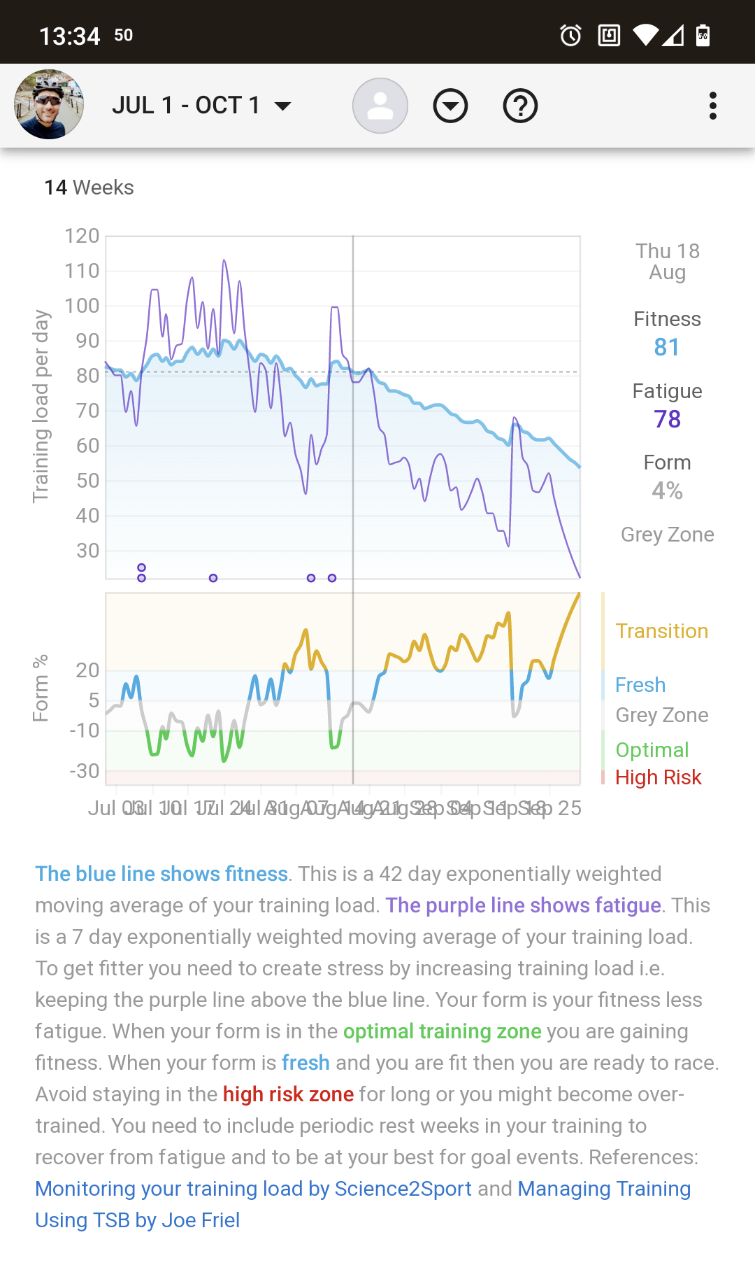

Hi all. I have my Training Peaks calendar synced, but my fitness graph doesn’t show future fitness. Does intervals pull the load from TP or just the workout name? It looks to me like it is just the name… if so, is there a way to get the load/tss to come through? @david

your fitness is around 80 so it means 80 tss abg for a week and the trainingfrom the picture is like 50tss avg so the graph is deeping

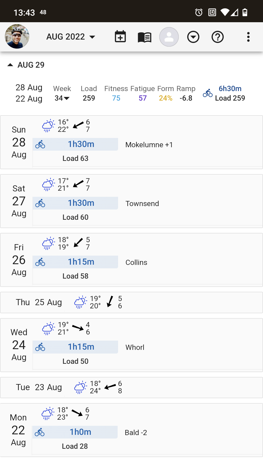

so for example your trainings are around 60tss and 1h30m long that means they are below treshold and are more or less not that hard and on mon 30tss is easy ride
Important: ftp test is crutial to set your treshold, all other data is taken from your ftp or hr. It would still be 1h=100 tss but if your ftp is too low your training will be too easy and if too high you can overttain yourself. Or in other words with frp set too low you ride same watts but interval thinks all the rides are above ftp and you get high tss score or if ftp is too high interval thinks your ride is very easy and give you very low tss. So some people push harder and they train too hard even when the score is low.
Load 259 is just your weekly tss sum and you can divide by 7 to get your avg weekly tss 259/7=37

Your fitness chart shows rollng avg of your load from last 62 days (if i remember correctly the number). But your Ffitness is 81 and not 37. That means the week from the picture is very easy compared to previous ones (you have 81 tss avg for last 62 days that means some of the days were really hard and or very long -it iis hard to ride more then 1h @ ftp and get tss above 100 but still you can ride easier for 5 hours and you will get 150 tsso or more). Second possibility is you’ve changed ftp to much higher (earlier weeks were with much lower ftp and intervals sees them as all above ftp). As i said earlier it is always 1h@ftp100 tss so if you had your ftp set too low you could rget high fitness score without riding a lot. You just got a lot of time above ftp. Evry ride has its own ftp so you can just check some of the earlier rides.
Fatigue is just your weekly avg tss so i see many weeks above 100 which is very very hard. After such weeks you ahould take a rest week or there is a high possibility your body will find a way to rest (injury, ilness …) assuming ftp is correct
Form is Fitness minus fatigue (more or less)

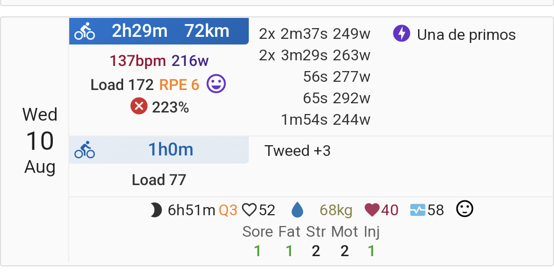

That is to say (see img above), there are days when I should do intervals with a TSS of 77 and I end up doing an outdoor route of 172 TSS. Here I think the problem with my Fitness tab lies, as you rightly point out: having done a few weeks with a lot of TSS, the workouts of the current week (and future weeks), do not produce enough fatigue.
I will definitely try to add those rides to the calendar. The only problem is that they are planned on short notice, often overnight! Thanks for your help, things are becoming much clearer :grinning_face:

  1. Very easy and it`s more of a hack then solving a problem. It would be to set the unscheduled rides as irrevelant for counting your load (it is the first option in actions menu of your ride). Then the graph would correspond to your tr plan. You should not do that but the option is there. The graph would be nice but irrevelant.
  2. Much better but harder would be to correct your plan accordingly. I mean if you can ride longer and harder then your plan thinks and more importantly without negative overtraining effects, then you should stick with your group rides when you want but edit all the planned workouts accordingly. So for example:
