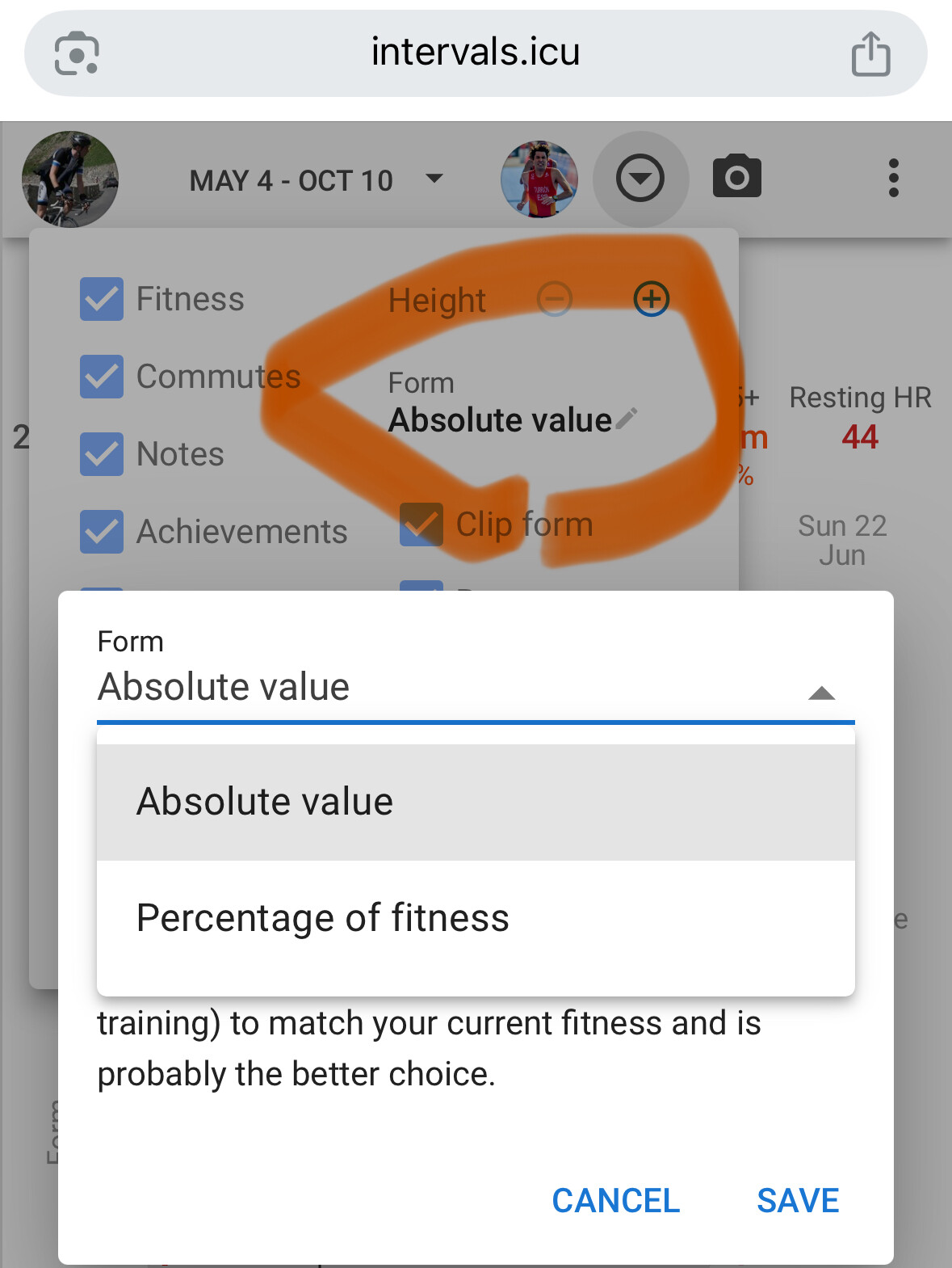

This kind of riding is prob an edge case for these models. That being said, what do you get when you change this to percentage of fitness?
You can read about that here:
Read the post just above also to better understand what the Fitness chart is doing.
