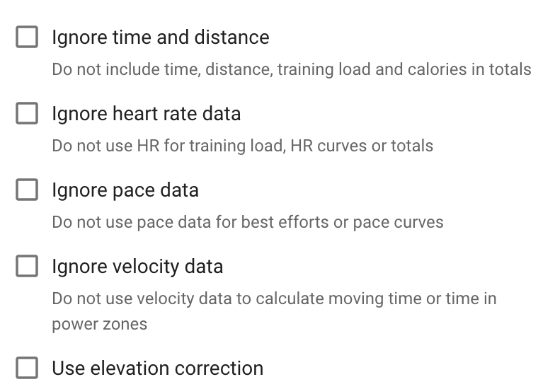

Did you press the START button before all sensors and satellites are obtained?
If you did, and the 1st 1m26s didn’t have any GPS data / Velocity / power etc, then it might be the reason why it’s regarded as “non-moving” time and ignored.
You can try these
