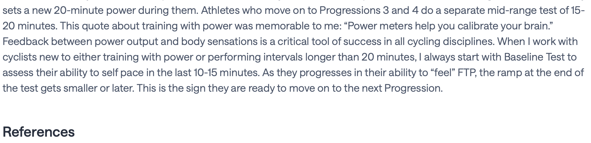

The description in the article states:
Before doing any of the following FTP tests, you must do a long and thorough warm-up. Your FTP will be equal to the average power of the “entire test”, and I double check it with the WKO modeled FTP.
He differentiates between test and warmup, therefore it’s the entire duration of the test, not the warmup. So if you do the baseline test, it’s then 35-45 minutes or TTE (whichever happens first).

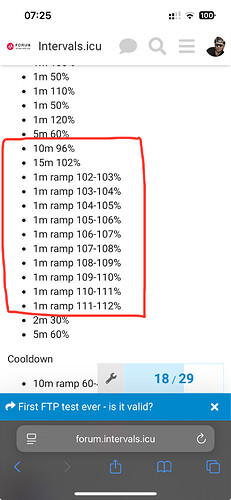

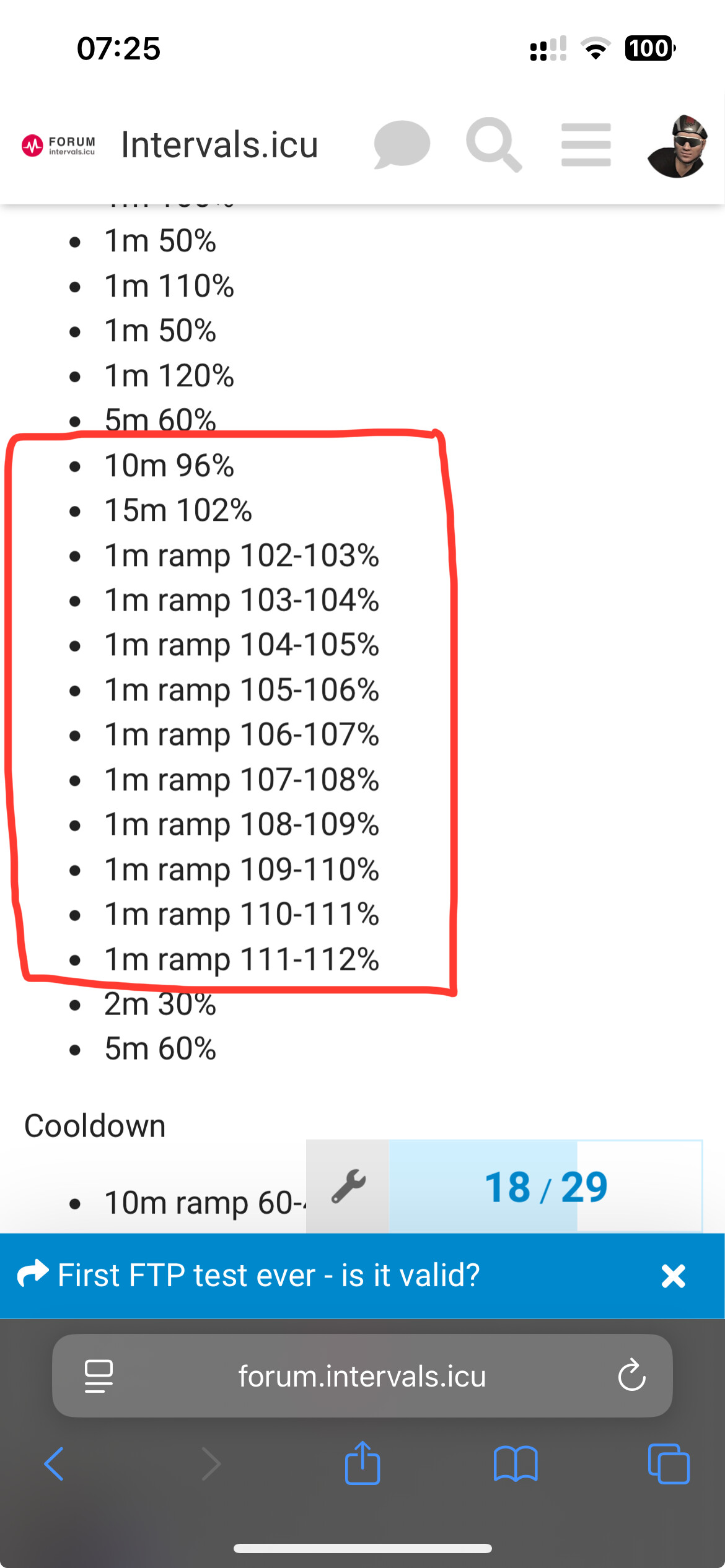

I saw that, but the protocol he apparently posted on Trainer Road (First FTP test ever - is it valid? - #9 by rswagler) doesn’t even match up with the protocol in the linked article. Based on the protocol posted above, I presume the “test” would start at 10 min @ 96%?

Pay attention to the end of the article:
if you already are good at pacing, Friel’s “solo ~30 minute time trial” is basically a shorter version of progression 3 in that article. If you aren’t good at pacing, you can do a ramp test or 20-min test to get an estimate of long power. Then use that and realize you can’t “fail the test” unless you refuse to pay attention to your body sensations.
Yes, the test starts below the “target” power, for 10-mins.

It’s TrainerRoad, where the protocol is listed into defined steps, probably for the ERG users on that platform.
