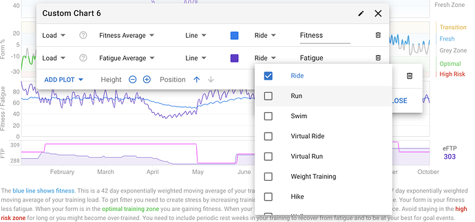

maybe I missed it but I didn’t find a way to filter the default global fitness charts by sport.
I can recreate each of them with filters on it, which is very good, but I loose the nice colors. Also additional form chart cannot be set as percentage (or maybe I missed that).
Regards
Julien
That chart is plotted from pre-computed running totals stored on each activity. This makes it possible to get fitness and fatigue very quickly just by looking at a single activity. The disadvantage is that I can’t filter that by sport.
To compute fitness in particular you need to start at the oldest activity and work forward. The custom plots go back 84 days before the oldest date on the chart when “fitness average” (42d exponentially weighted avg) is in use. This actually produces fitness numbers that are 1 or 2 under. The pre-computed totals look at your whole history so don’t have that problem.
Anyway the moral of this long story is that it isn’t easy for me to add filtering to the main chart. However I will probably add separate running totals for swim/bike/run at some point.
I will add a new “Form %” plot. Missed that.
Oh good, thank you very much for the detailed answer.
Indeed, by playing a little bit with custom chart I saw this little difference but couldn’t understand the reason. Thank you for explaining that too.

You can do it using custom plots:
