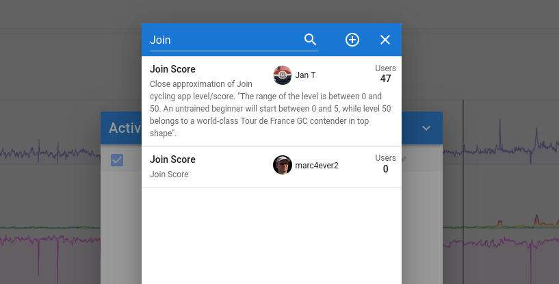

Added a public activity field called ā€˜Join score’ that is a close approximation of the score/level as provided in the app. It is a script based on FTP/Kg and CTL so no Join subscription needed. When adding it to an activity (custom > search field) and then re-analyzing historic data (select all in activity list view > edit > analyze) it can be used to show the Join score trend in the ā€˜compare’ tab. Note that using different outdoor and indoor FTPs will affect the data.

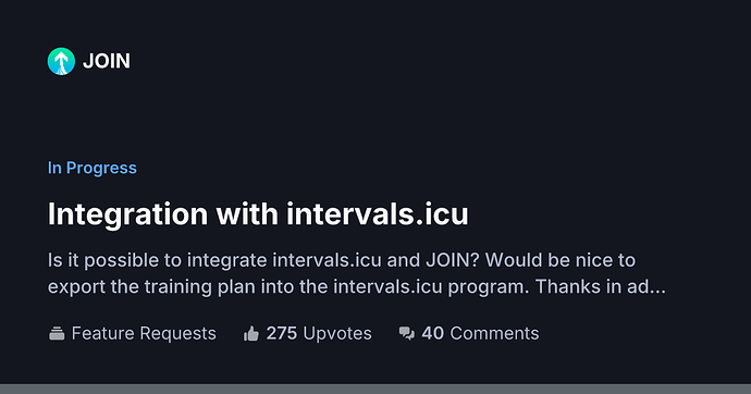

I would love to see some kind integration between the two. I have really grown to like JOIN Cycling. Right now I email the workouts week to myself from JOIN as a .fit file an upload them to here. It works just fine, but takes a little work.
That would very likely have to be done by JOIN. You could try contacting them. If enough people ask it might happen.
I actually just sent them an e-mail with this request. I was trying the manual process by downloading the ZWO file (which JOIN) emails to you, and the import using the activity (add entry in Calendar). However, this didn’t work on my iPhone as I couldn’t select the ZWO file using the File Select dialog. The FIT files that JOIN can also email also didn’t work as there was no start date entered (error reported by JOIN). Strangely, on my MacBook I could simply upload and select the ZWO file.
Also, the upload function in the calendar view doesn’t allow selection of ZWO files? Might make it slightly easier to upload manually and once intervals detects a ZWO file, then open the Add Workout entry with everything filled in automatically?
Found this through the JOIN requests website and tried you approach. When I add your custom field, the script it empty? And edger re-analyzing an activity, the field remains empty! Could you perhaps share the script code or am I missing something?
Just asked to create an API with intervals.icu. See screenshot for their answer.

It’s a ā€œcustom activity fieldā€, added through Activities > Any activity > Custom (not Fields, which confusingly has some similarly named fields which do not work).
Here is the script:
