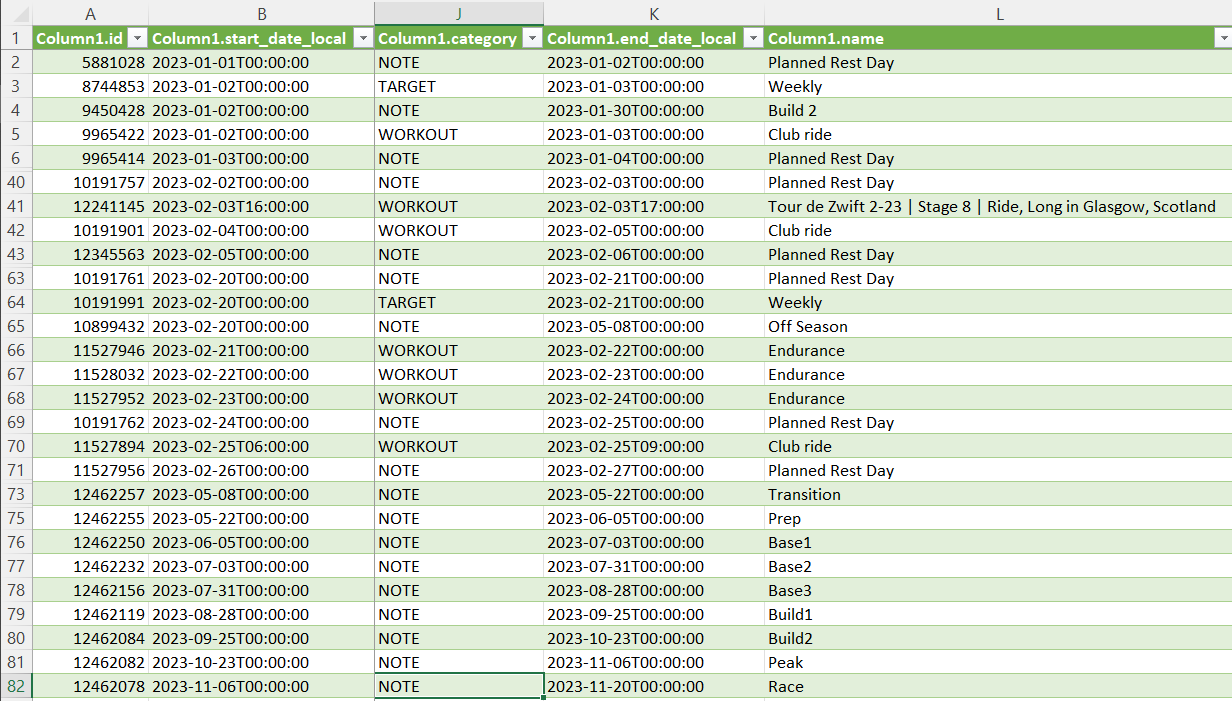

Based on the information from David, it is possible to download the data into Excel.
If you have a basic knowledge of the API and importing data using the power query (and editor), it’s quite simple. Let me know where you get stuck, and I’ll try assist.
https:// intervals.icu/api/v1/athlete/[insert your athlete ID here]/events?oldest=2023%2F01%2F01&newest=2023%2F12%2F31&resolve=true
Remove the space between https:// and intervals.icu/api/v1…
Change the date older and newest.
There are a few steps to get through in the power query editor, but once it’s sorted, the download should work every time.

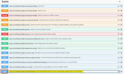

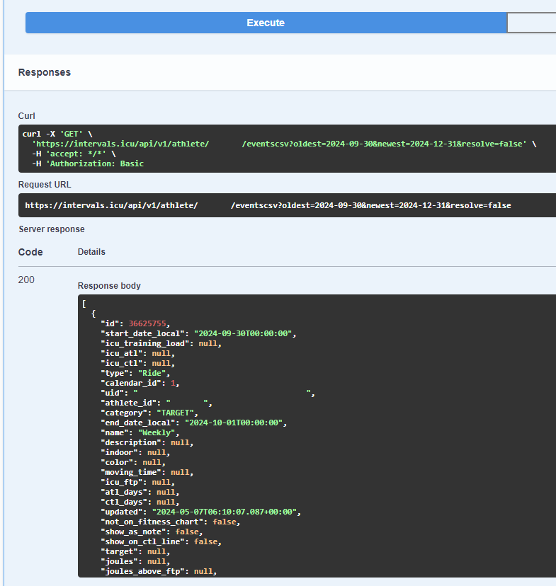

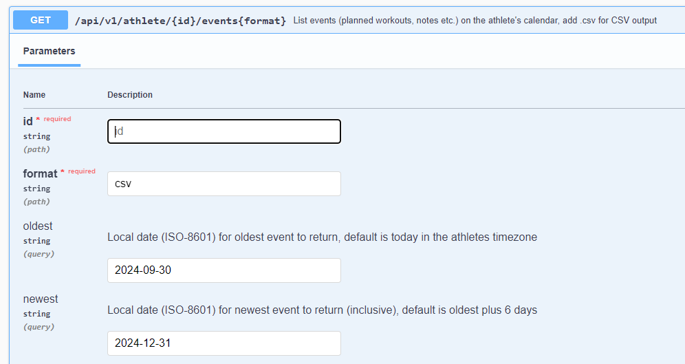

Step 2: The URL link from Intervals API:
The link is shown in the API documentation in Events future events/workouts:
https ://intervals.icu/api/v1/athlete/[athlete ID]/eventscsv?oldest=yyyy-mm-dd&newest=yyyy-mm-dd&resolve=false
Settings to use are:
  • athleteID
  • csv
  • start date
  • end date
  • Using the Swagger API docs webpage, you can get this and more
    Execute - it will return the Request URL and some data.The Request URL is all you need.
  • Above, in step 2, there are spaces in the URL, so that it doesn’t show my data (private), and also not show an error. Make sure that all spaces are removed after the https
  • Highlight the text between square brakcets [ ] as well as the square brackets, and replace with the athlete ID (found in settings).
  • oldest= the date you want to import from, eg. 2024-09-09
  • newest= the date you want to import to, eg. 2024-12-31
In my test ATP file, I used 2024-01-01 to 2024-12-31 to get data for the full year 2024. However, I only need to update the planned load from 2024-09-09 to end of November (I haven’t planned beyond November yet).

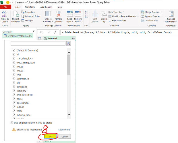

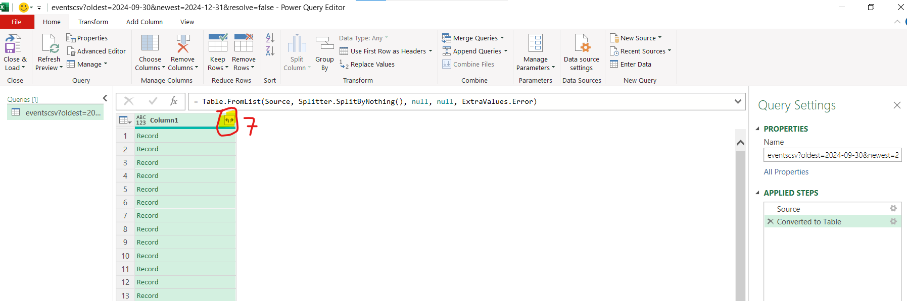

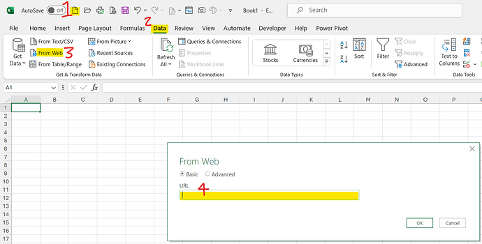

In Excel, the steps are simple (atleast I think it’s simple):

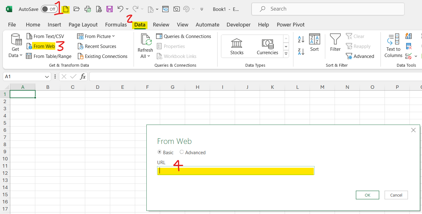

  1. Open sheet
  2. Data (toolbar ribbon)
  3. From Web

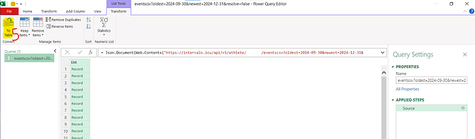

  4. Copy and paste the Request URL

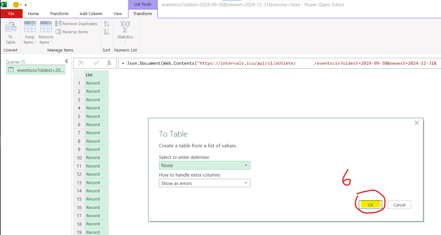

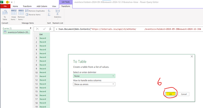

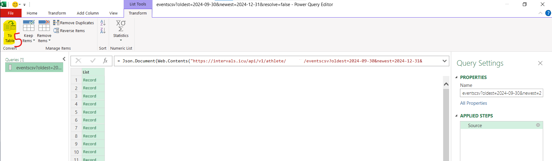

  5. Transform to a Table
  6. Click OK for the next dialog box

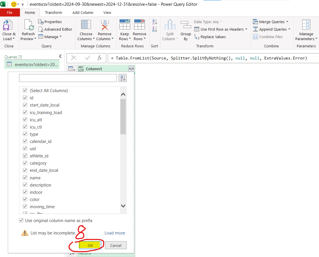

  7. Convert to columns
  8. Click OK

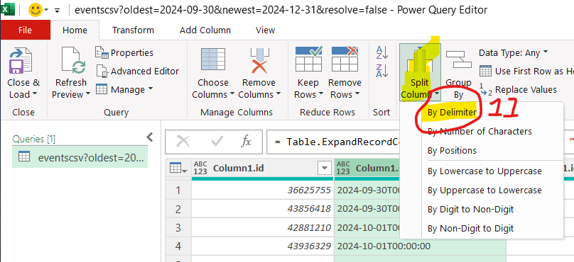

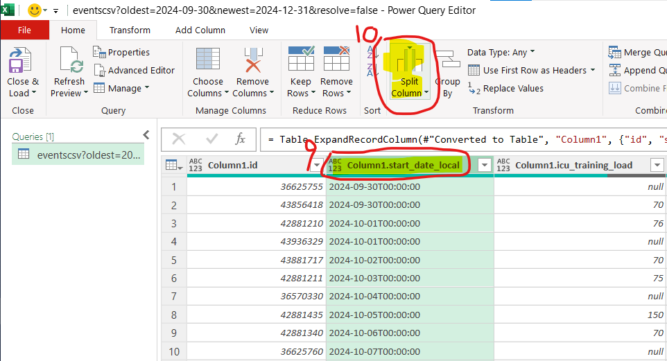

  9. Click on the date/time column header
  10. Select Split Column (to have two columns of date and time)

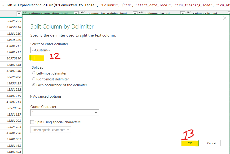

  11. Select By Delimiter - the letter T will be the character used to split the columns
  12. Type T
  13. Click OK

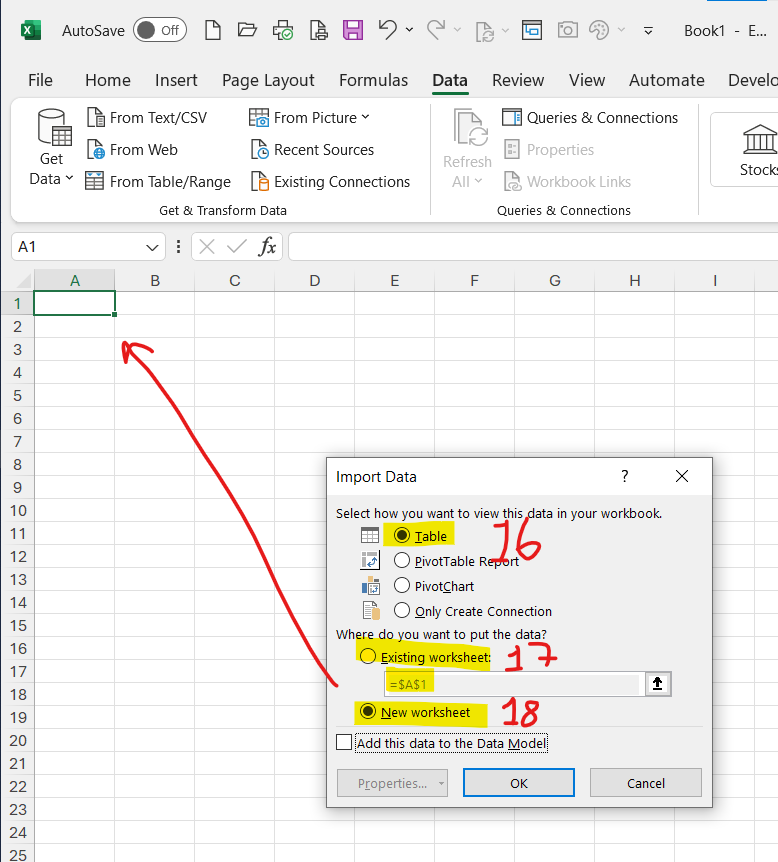

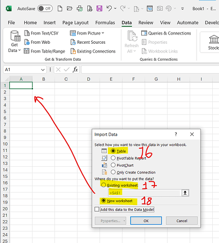

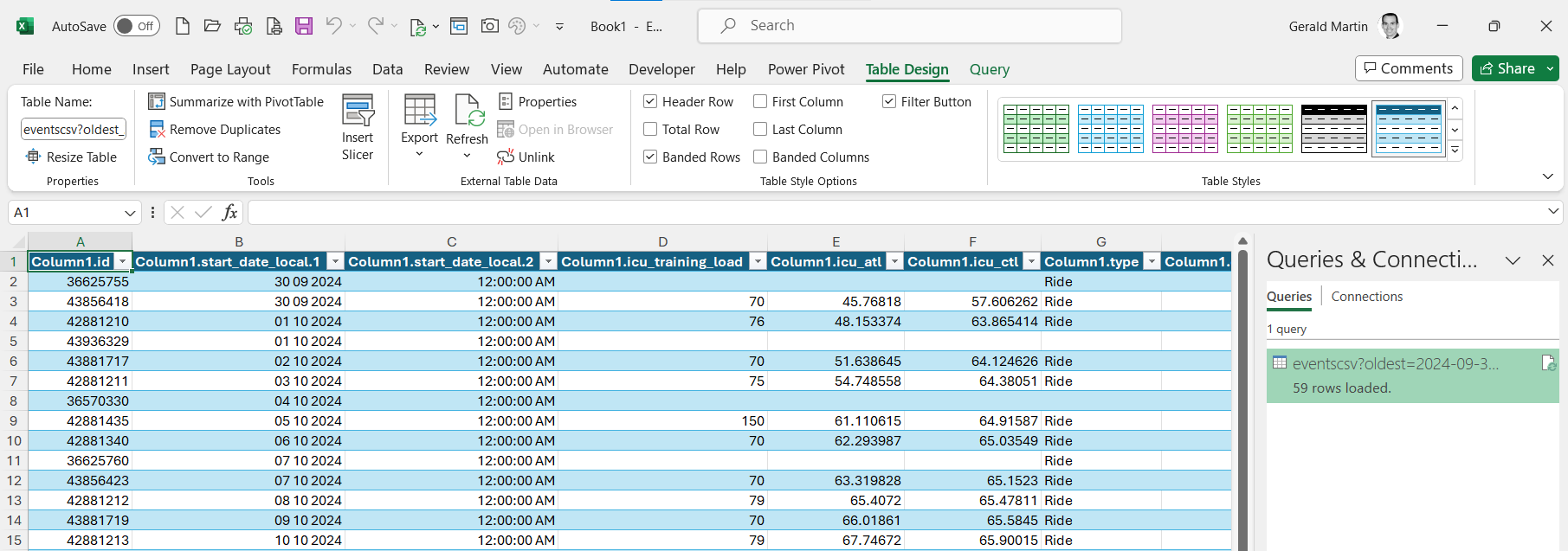

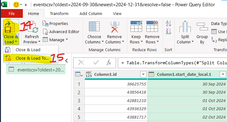

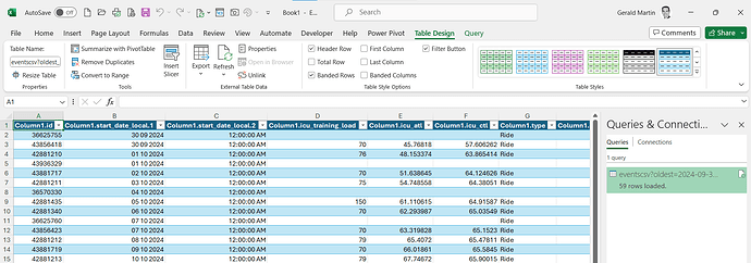

  14. Close & Load (pastes in the cell A1 (assuming you didn’t select any other cell when creating the new file).
  15. Close & Load to… (allows you to choose the Tab and cell to paste).
16-18. Options listed above to paste.
Click OK, then it will load all data.

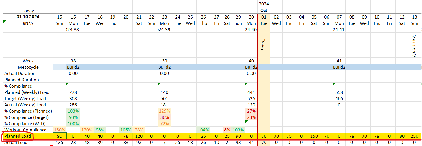

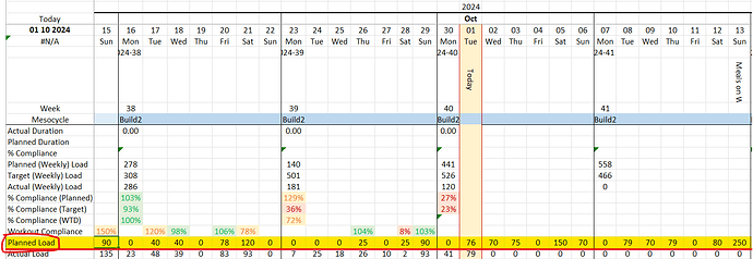

Column D is the future load
From there, you can lookup the future date, if you are using an annual plan.
Here’s a view of a file I have setup, but not used in recent weeks. After updating today, it shows planned load, actual, and some other data.
