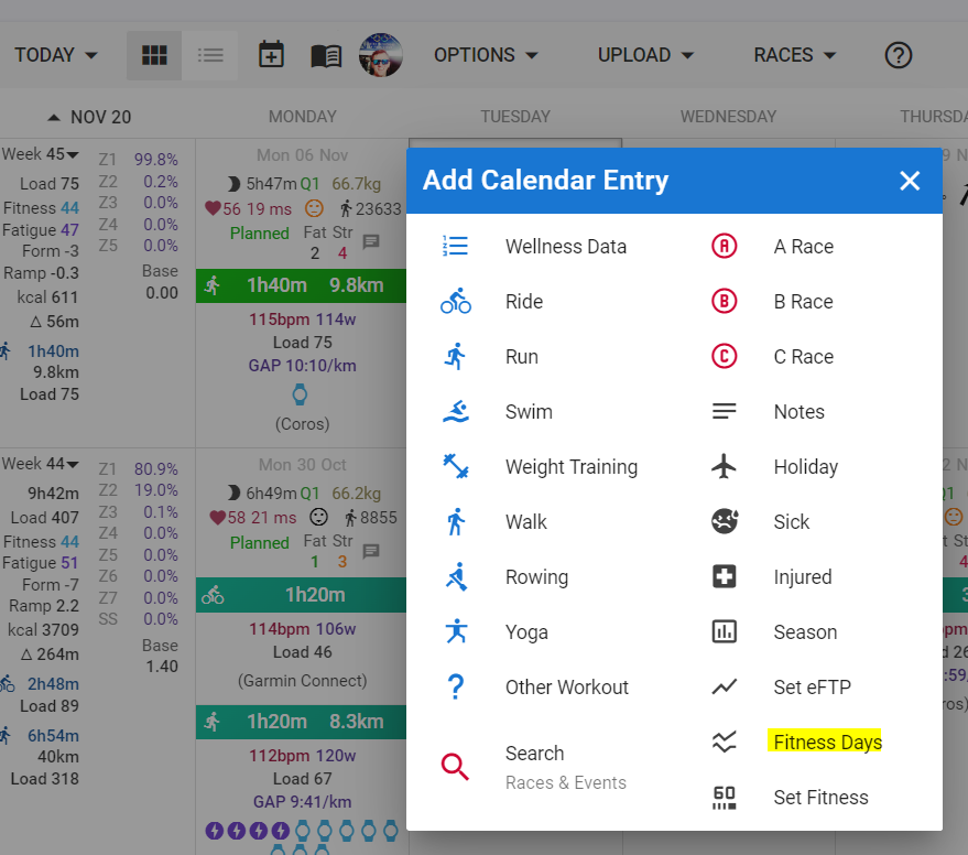

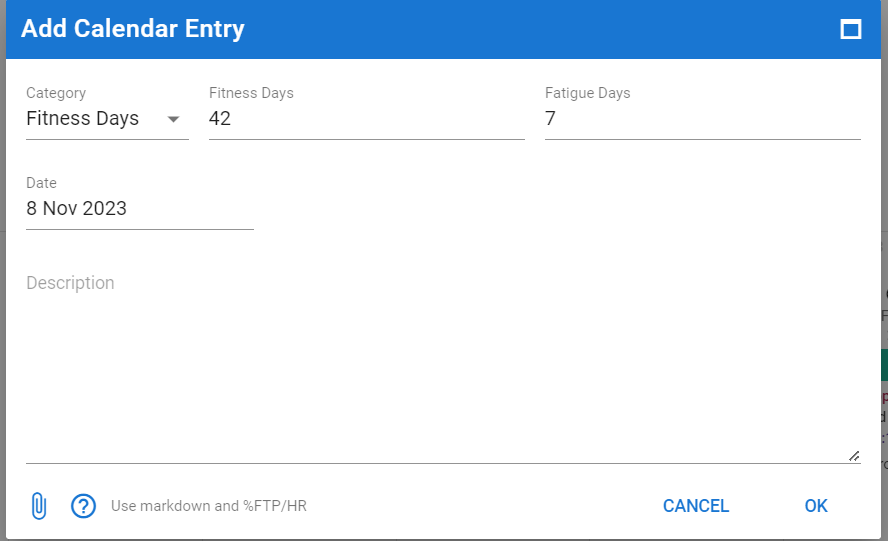

I’m not sure if this is what you need but you can set the days for fatigue and fitness
Thank you for your reply… no, it’s not really what I need.

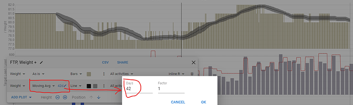

Do you mean like this?
Not sure if you need exponential average or just simple moving average.
It seems you want to evaluate average for last N days, so it is given by N points moving average.
