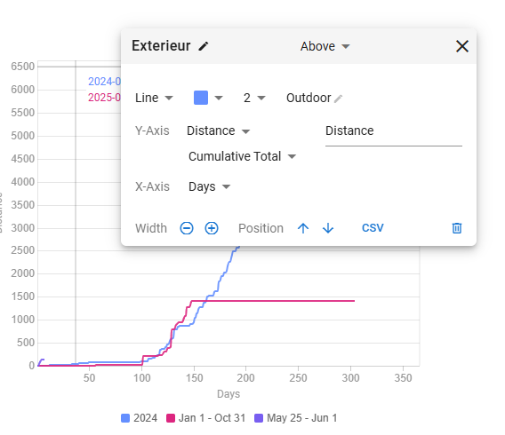

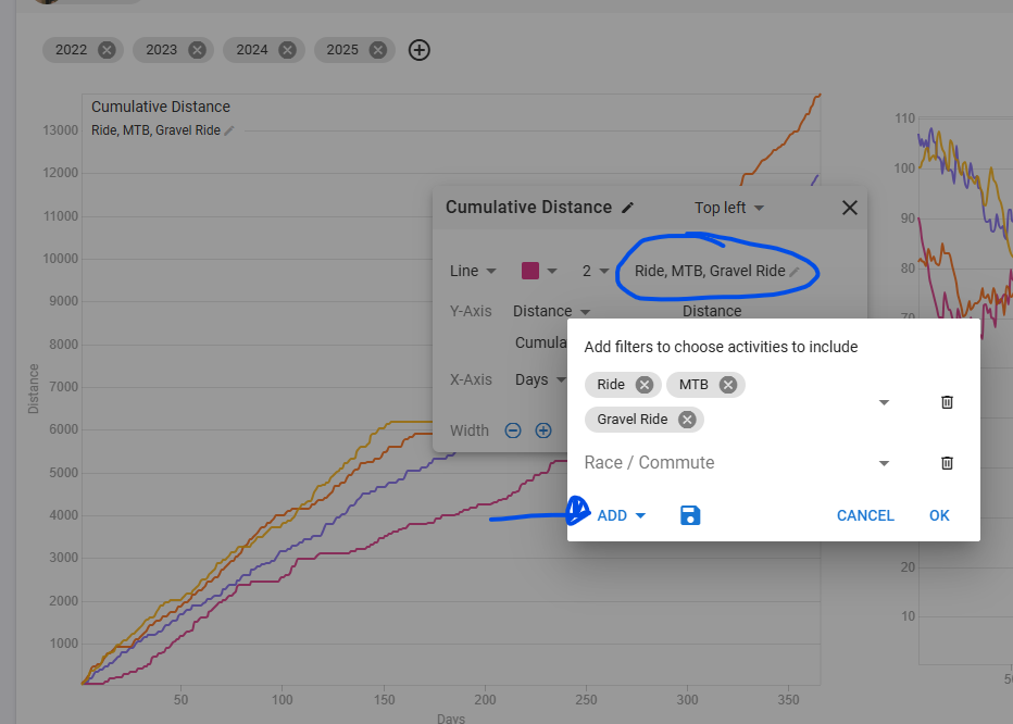

in the /compare page, I have a graph for outdoor activites.
But I want for that graph EXCLUDE the commute ride that are tagged as Commute Ride in Strava .
How can I do that ?
Here the setting of that graph…
Yes, you can.
Go to the filter option where you selected outdoor and add race/commute.
That is, if all your commutes are marked as commutes.

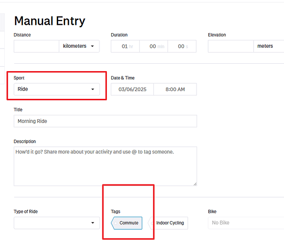

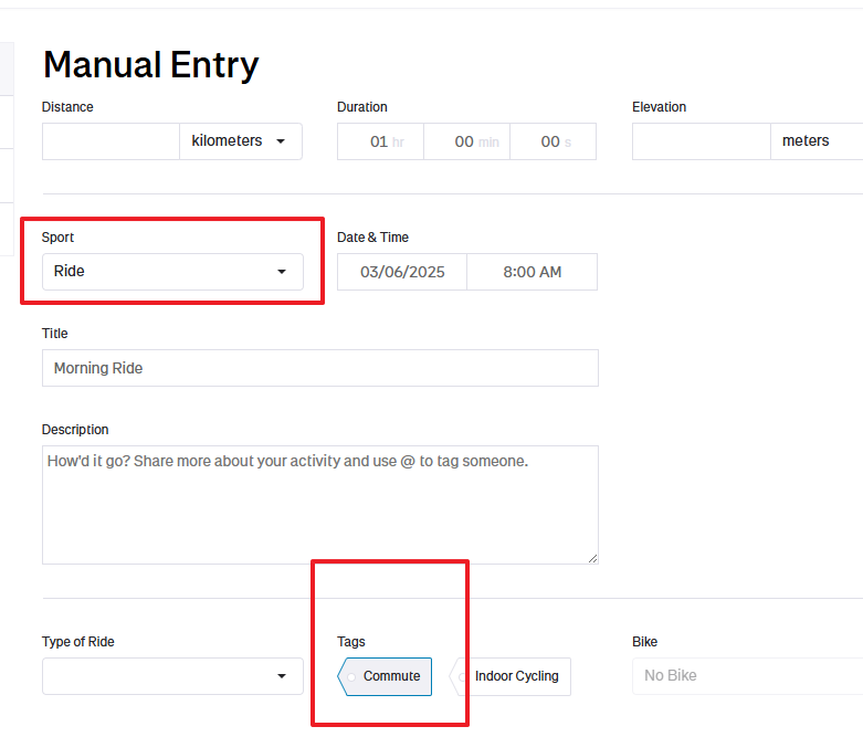

In fact in my case not possible because in Strava my commutes are Ride but with the tag Commute
I dont known how Intervals can handle the STRAVA Commute TAG

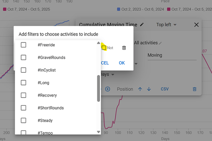

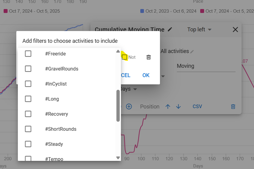

If it is a Tag, add a filter for the Tags, select Commute from the list and check the NOT box.

It’s not an interval tag , but the tag from Strava as shown in my last screenshot.
I dont known if interval.icu can see the STRAVA Commute tag ?

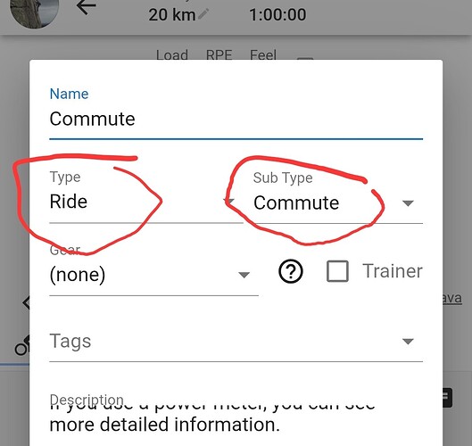

Okay, so i just see that STRAVA commute, is seen as a subtype of RIDE in intervals as shown in my screen show below
I still cannot exclude the subtype “commute” from my graph .

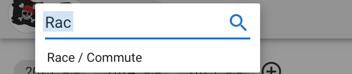

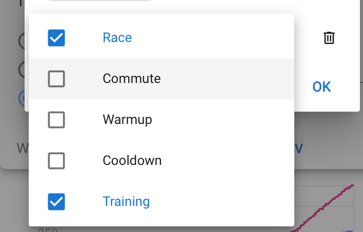

Search for commute
Select the subtypes race and Training to exclude commutes
thanks it works now with your method! @R2Tom
