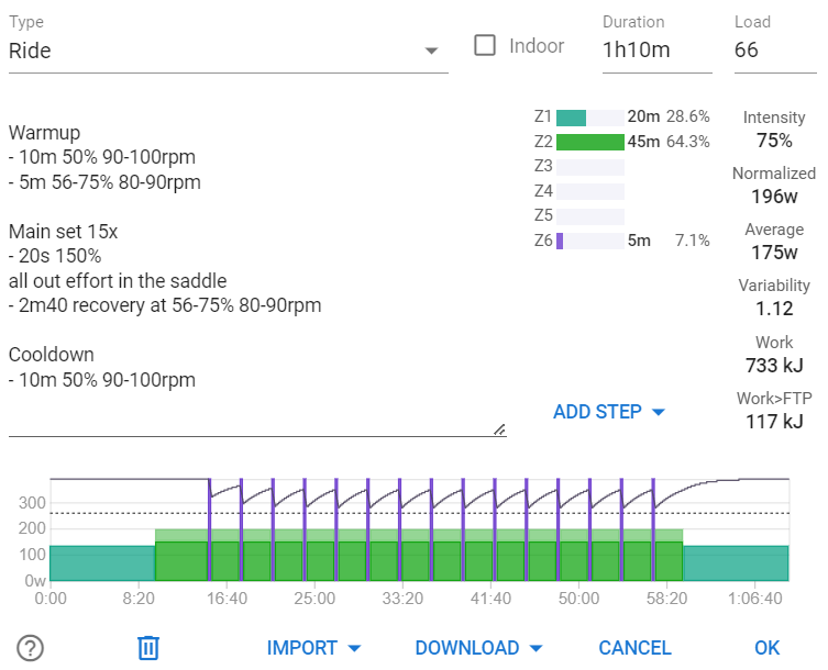

Here are two examples where TSS is similar (5 point difference) but they are completely different types of workouts.
15x 20sec sprints with the rest in L1 or L2
Only 5 minutes of accumulated high intensity, and 65 minutes of L1/2 work.
Edit: looking at the description, I need to edit… it’s not all out effort, but only 150% of FTP.
TSS is 66

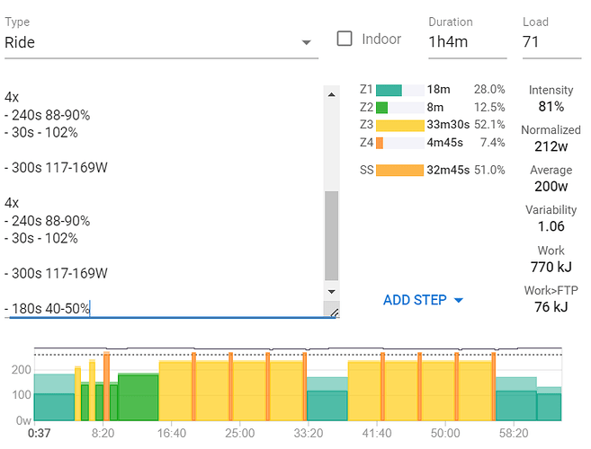

Compared to a sweet spot/tempo workout with a lot more work in Tempo and Threshold levels (mostly sweet spot).
71 TSS
@Gerald if i understood correctly, you said that 4 short(around 1 hr) threshold sessions on the final weeks would lead to too much fatigue.
What if i do like 2 sweet spot or threshold 1 hour sessions combined with 2 easy z1/z2 rides of around 1h or 1h30 for those weeks, even if tss is a bit lower around 300 maybe. Would this be better? Being my event mainly climbing i think 20 secs sprinting would be a waste of a time for me, but maybe im wrong. U guys are the experts.
