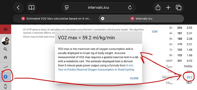

If you click on your VO2max estimate on the power page, you will see that it uses a 5-min max effort.
